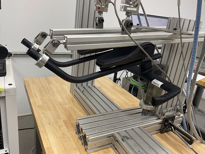

I visited the factory in March. They are making for primarily 2 big established brands , other than their own in house stuff. This frame has been under development together since last October. The hardware I’m developing for this bike is the same as I will offer on my carbon stem aerobar. Chinese factories only test to EN standard of 1 time force applied at the bar end for assemblies. All the suppliers I spoke to basebar test is comprehensive, but few do extension and assembly testing. I just got the lighter material samples and set them up for fatigue testing . Should get results next week. The reach is beyond what’s on the market so if it fails we may need to retest with shorter reach. Also the 22.2 has 3 widths and testing in the widest. Brands like wattshop, profile design, etc go the extra expensive mile to test aerobar safety. It’s a long expensive process but we hope Jeroens sales and my new product sales justify the cost and time investment.

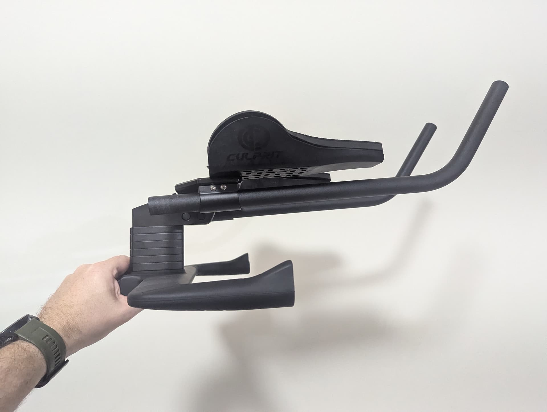

Yes, there will be a frame only option with the Culprit cockpit hardware available.

Is there an option with the risers for stock angle? Eg adjustable angled riser etc
The design is 0 to +30 degrees
What kinds of failures would you expect/have you seen in this kind of testing?
Make sure that the 0-30 degree is not stock on the Avenger bike, the cockpit as we are going to launch it will we different from the Hong Fu model. What we designed with Culprit is completely different from the default cockpit. And I would even say that these cockpit parts make the bike so good in the fit range. Without the frame geo is still good, but much more limited in fit range and options

Okay, not the news we wanted but the base bar didn’t passes the testing of today. To be transparent and fair, we did test beyond the limits of how the factory designed the bar.
Hong Fu allows a max of total of 75 mm spacers incl. the rest of the hardware to mount the bar. No reach option.
We tested at a total of 120 mm with reach and that reach extended to a very max and that didn’t passed the test, unfortunately. And unfortunately it was way off. It needs to hold 100k cycles of force and it is not like it got to 90k……
So we are going to test again now at factory specs, see how that holds because we just might overdone ourselves in testing to on extreme levels that likely nobody ever needs.
And if that passes the test we will continue in a way to add reach and test that, if it passes add 10 mm extra spacers, etc.
Or we will design a completely new base bar.
What we learned, again, is that buying untested stuff like reach extenders from companies that do no real fatigue testing on your base bar is dangerous. You can buy a lot of different reach extenders these days, various brands, but if your base bar isn’t designed for it it is just dangerous for you and others around you.
There are great companies like Profile Design that tested their reach extender on their bars where it fits on and that is safe to use.
Again, not saying at this point the base bar is the issue, it might be that we just overpushed it in stack and reach. We will know after the next few tests.
