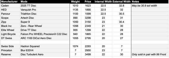

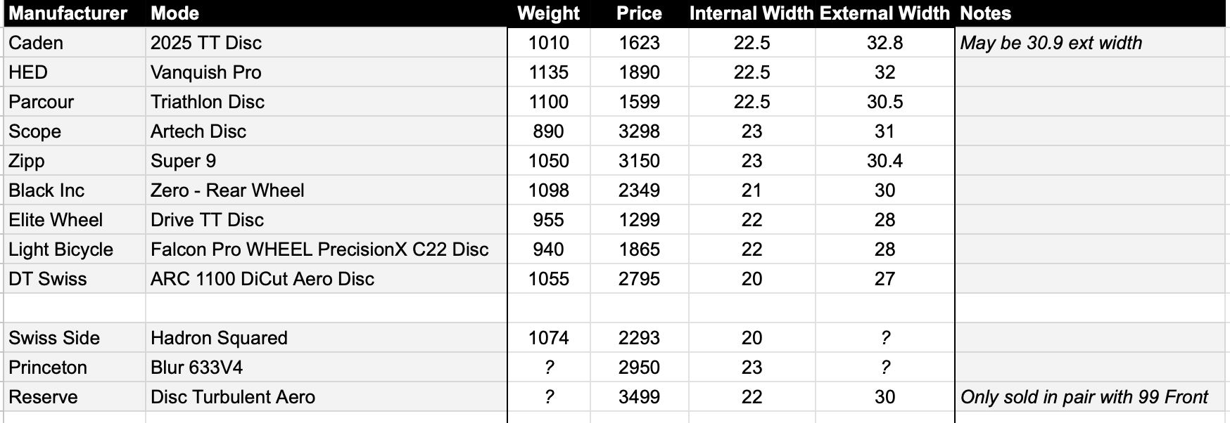

Compiled everything I could find. Any wheels I’m missing? Can anyone find the missing specs for the Swiss Side, Princeton, or Reserve Wheels?
IMO it’s not worth buying anything with an external width <30mm (assuming you want to run a 28mm tire which will be more comfortable and faster RR). Given that, there are only 6 options and if you are trying to spend <$2k only 3 options. The Caden wheels seem like the best bang for your buck in terms of money, width, and weight.
Damn those Artech wheels are light…

I can’t imagine a 26.7mm ext width is good for a 28 or 30mm tire
