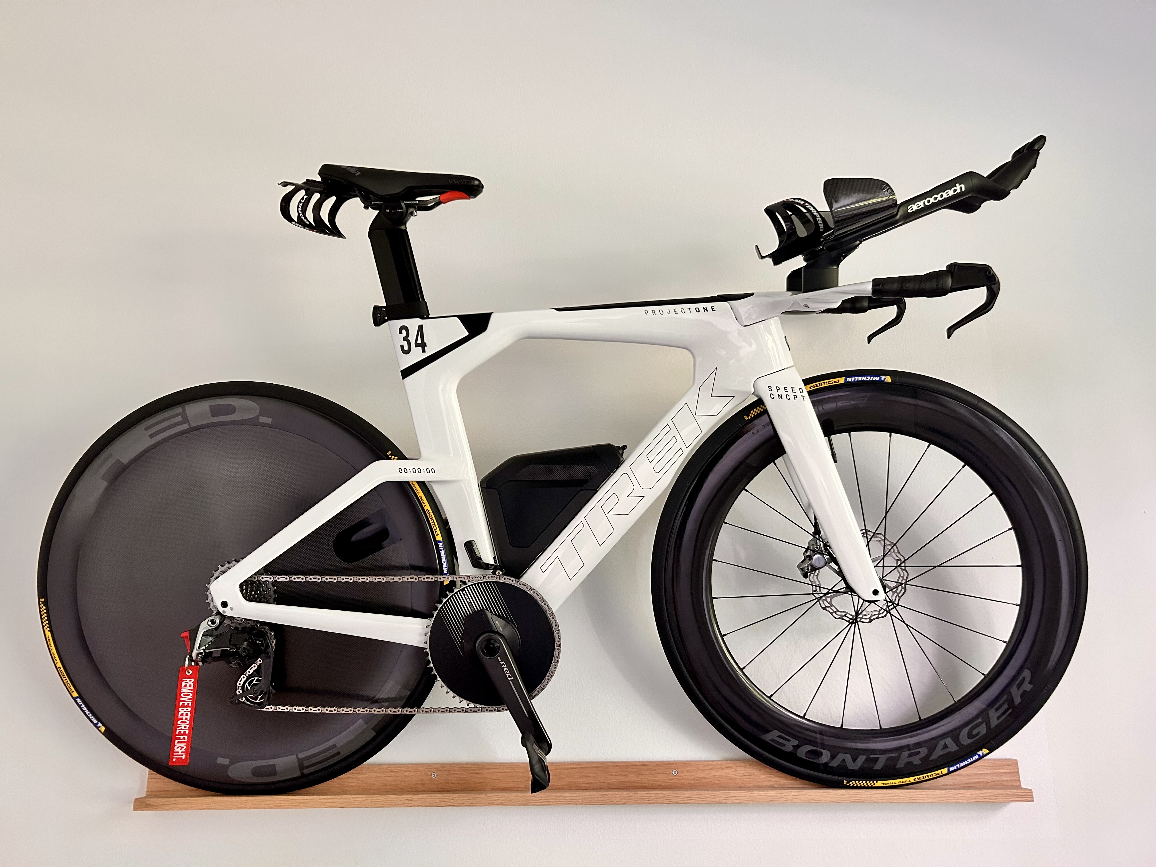

What about the HED Vanquish Pro?
1135g, Internal 22.5 / External 32mm
And if you opt for the grey decals, it pairs very nicely with the RSL 75!
Nice setup! I contacted HED a couple of times, but they were unfriendly and unprofessional, so I decided not to deal with them at all. It’s out of the question. The wheel also seems heavy at 1100g.
