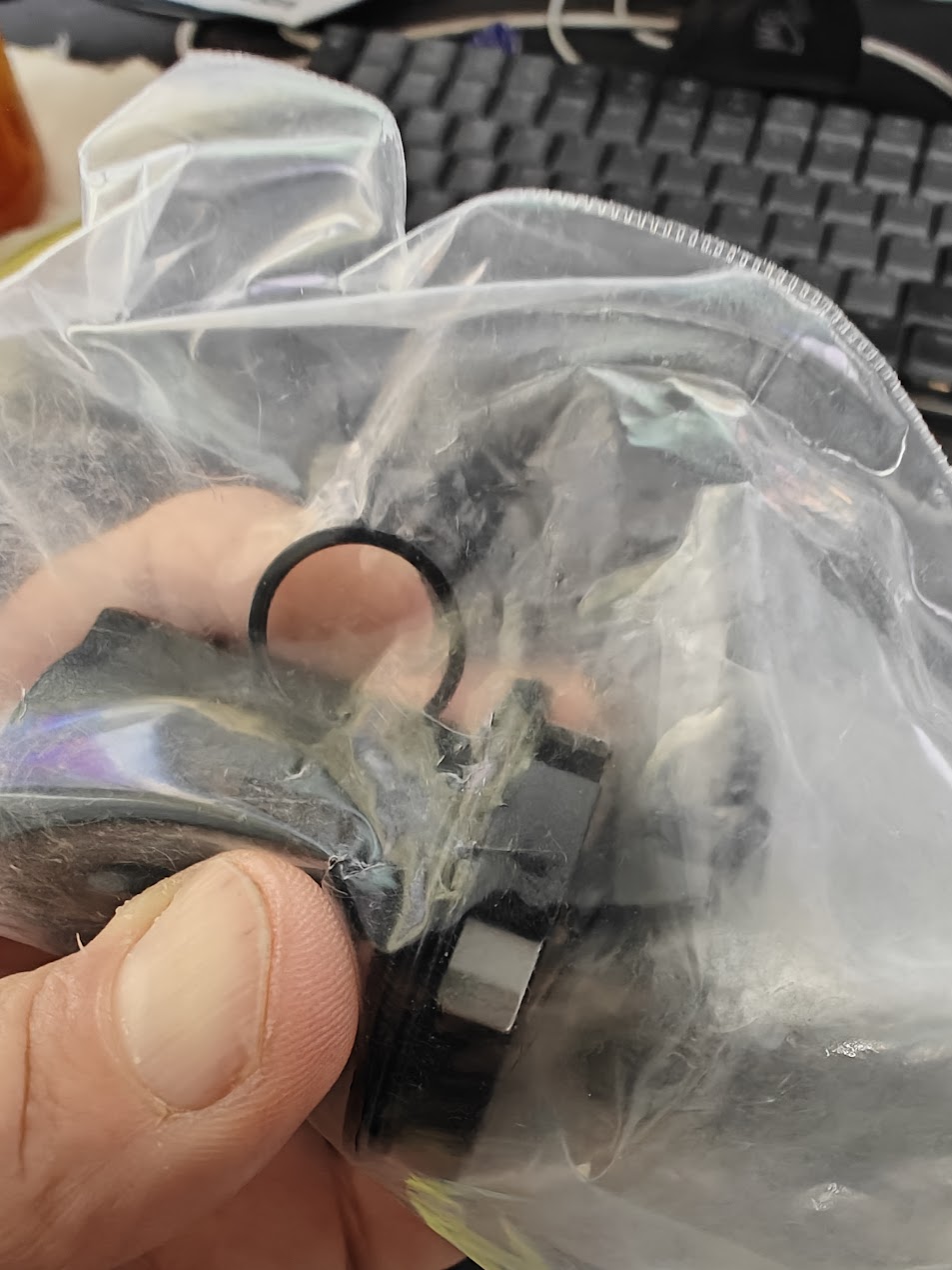

This is usually a result of this washer not making it’s way back inside the hub at some point -
Washer is where it needs to be. This was one of Hed’s troubleshooting ideas.
