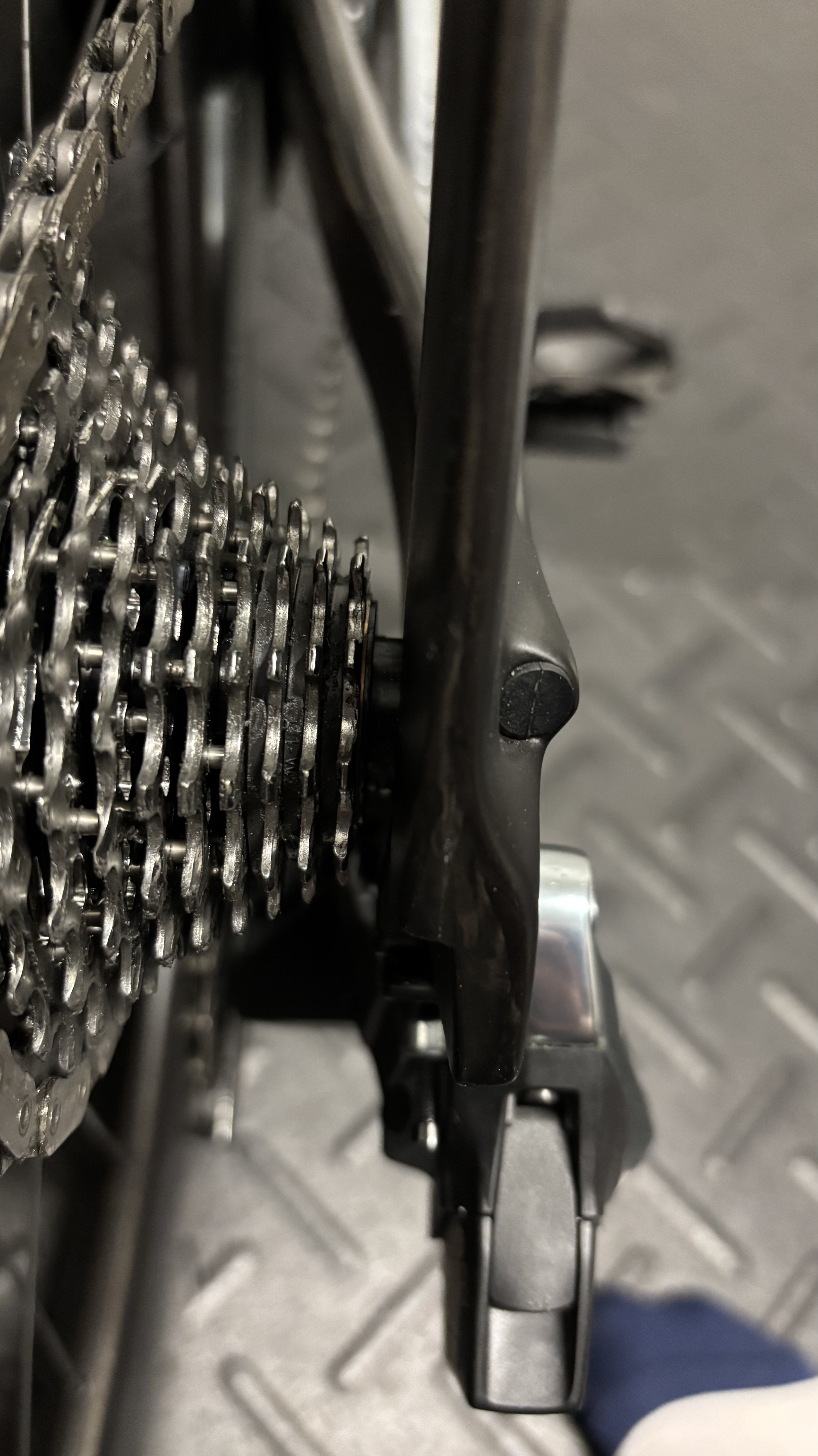

Freehub doesn’t spin as freely when thru axle is fully tightened
Does this happen if you put the wheel on another bike? Does it happen with another wheel on this bike? Does it happen with a different thru-axle?
If it’s an XD cassette, do you have the 1.85mm spacer installed?
XDR
Haven’t put it on another bike yet.
Another Hed wheel, yes. Premier Tactical and DT Swiss, no.
I don’t have another axle to try.
please post a Picture of the small cog end of the free hub with the cassette.

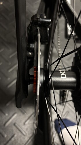

So, I had a similar issue when I was putting on my new Princeton Carbonworks wheels and it turned out that the rotor lockring was causing everything to bind. It would spin fine until I tightened the thru axle. I was initially using an Absolute Black center lock rotor lockring and it was for some reason, causing everything to bind in the hub. Changed it out to a basic shimano lockring and worked perfectly fine. Just my $.02. Hope you figure it out!
I literally took everything that attaches to the wheel and hub off and reinstalled one by one until I isolated the problem.
It was the lockring. I found an inner spline one that was on the DT Swiss wheels and it made a world of difference. The calipers need to be widen some too. Trying to figure that out.
I had the one on the left. Needed one like the one on the right. Much thinner.
The inner caliper piston is not detracting fully when the brake is disengaged so the inner caliper is pushed in a bit which is also causing a problem.
