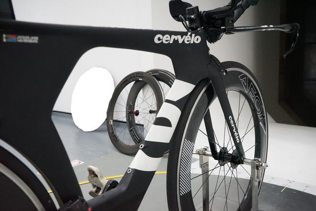

It’s us (AeroCoach) and there will definitely be numbers. Disc brake too as well as rim brake.

That tunnel look familier :wink: Do you have a date of release? And is it the fastest wheel?
