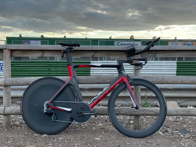

Photo attached of my 2016 Felt B14 with eTap AXS. Biggest issue was having to buy a new rear wheel with the XDR free hub.
Looks great!

Consider the Zipp VukaShift AXS extensions as well. They’re super clean, and mean you won’t need to hide a blip box.
Looks great!
I agree. Really nice set up. Thanks for the input on the extensions, tri-.
