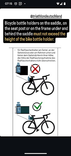

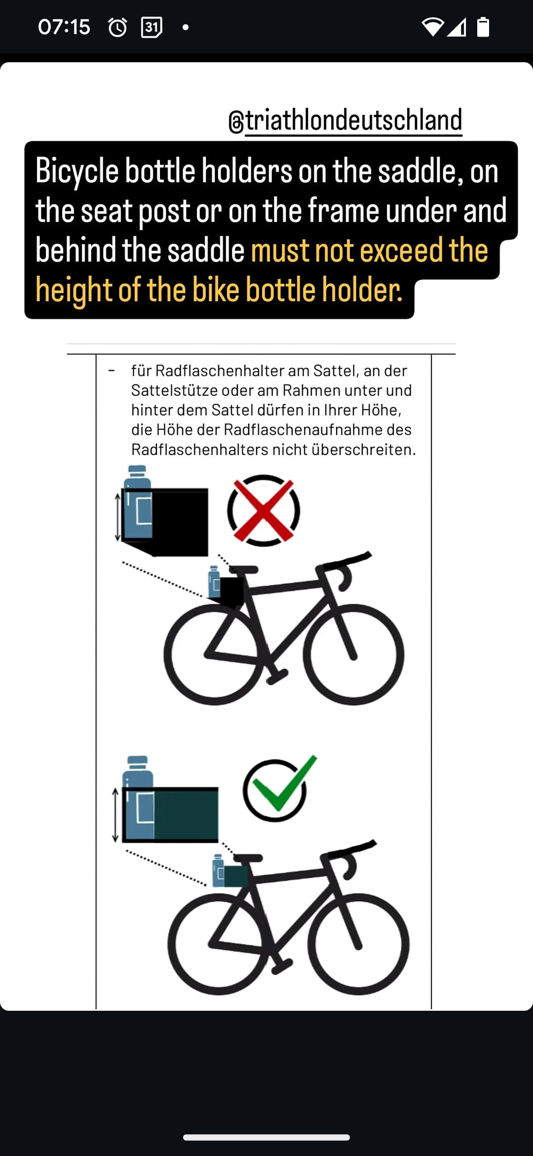

Ok, I went through the rules.
The German rules update covers the recent changes in World Triathlon & IM rules, e.g. regarding the 2l + 2l volume etc.
But then it goes above & beyond to complicate our lives: BTA bottle must be close to arms and cannot extend beyond the head tube axle, BTS bottle holders cannot create additional surface beyond what’s required for the bottle itself in the dimension of bottle length (I see no limitations on the width / distance between the bottle and e.g. seat post), no hydration allowed on top tube.

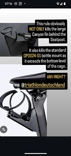

Well, regarding the rear bottleholder, i do not understand how to legally add a bottleholder on a canyon speedmax?
They would need a new mount, or you could use a saddle rail mount like xlab.
It’s not really clear how to properly apply the rule to angled bts bottles, so the existing (non wing) mount might end up being ok.
Someone at the DTU was just trying to mess with a major brand from Fra… oh wait :rofl:
ok, but how would that mount have to look like…?
i have two threads, 34 mm apart in the seatpost…
