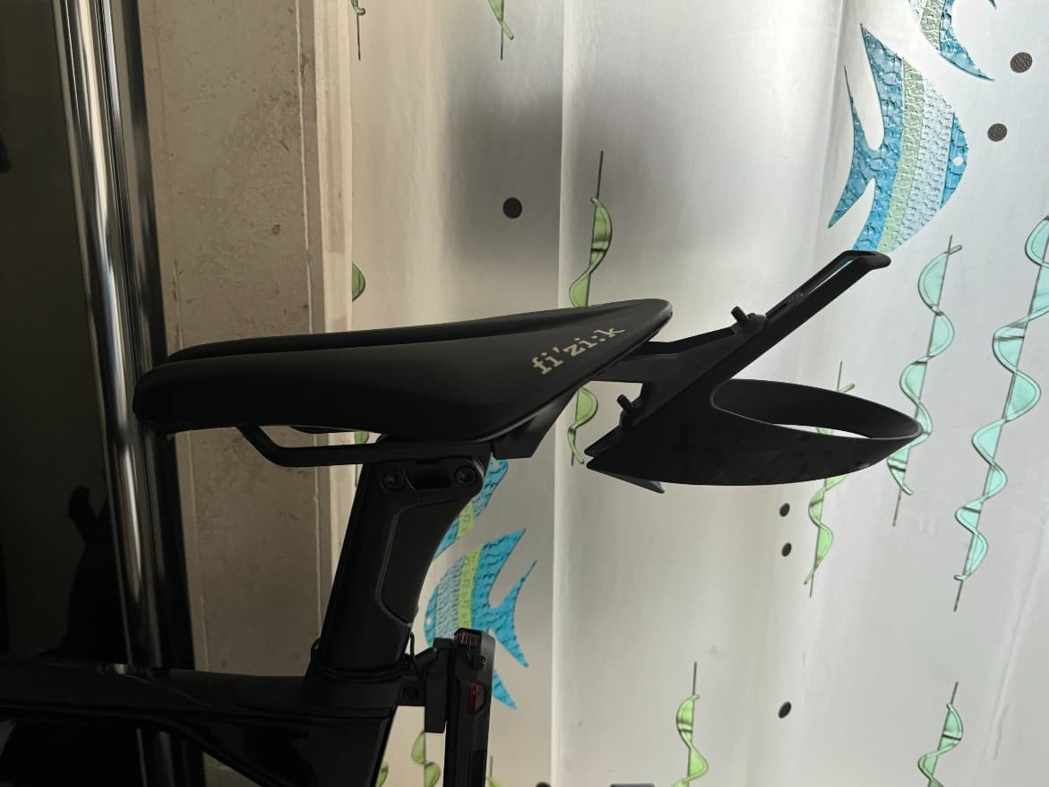

I don’t know the design of the Hydration Fuelcell, but a potentially feasible fix would be to limit the container to 1l (e.g. through inserting into it an additional hydration pack of 1l). However, the bike isn’t supported by Specialized anymore (it’s not produced - you know what I mean) and it’s not popular enough for having multiple 3d custom-made solutions.
Thank you for your opinion.
I do not use the fuel cell at all. It is empty (so no bladder inside) I do have a 3d printed bottle holder with one bottle on top.

The cage would have to be flipped for a compliant design (probably more likely to launch bottles though). Something akin to this, but attached to the seatpost.
