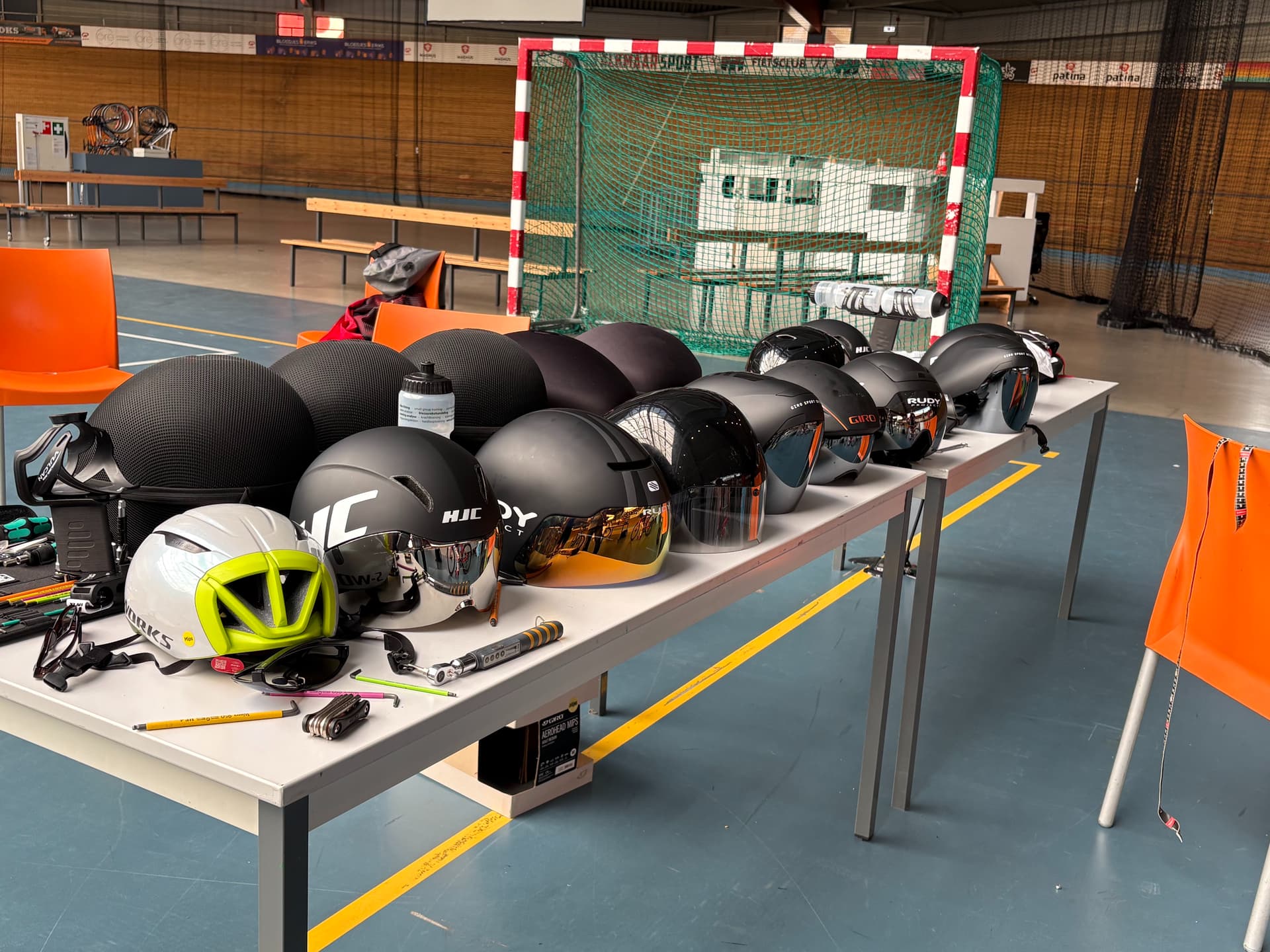

I am in the Netherlands and we are doing some testing. I don’t have final trends done, but the Evade actually did ok. Sometimes faster than some helmets in the below pic
we had 2 riders bring their own Evade 3 in, one of them seen here with some of the helmets they were tested against
the evade was never the slowest of the helmets tried

I was at the test where @marcag refers to. I wanted to know if my Evade 3 road helmet was an option for hot race conditions and actually was my 2nd fastest helmet. I tested 7 different helmets (Evade 3, HJC addwatt, Rudy Wingdream, Rudy Wing, Ekoi Pure Aero, Giro Aerohead, MET drone). For me, of course very personal, only the Ekoi was faster than the Evade 3.
But even on the track and short runs the Evade feels light and very cool compared to all the others.
