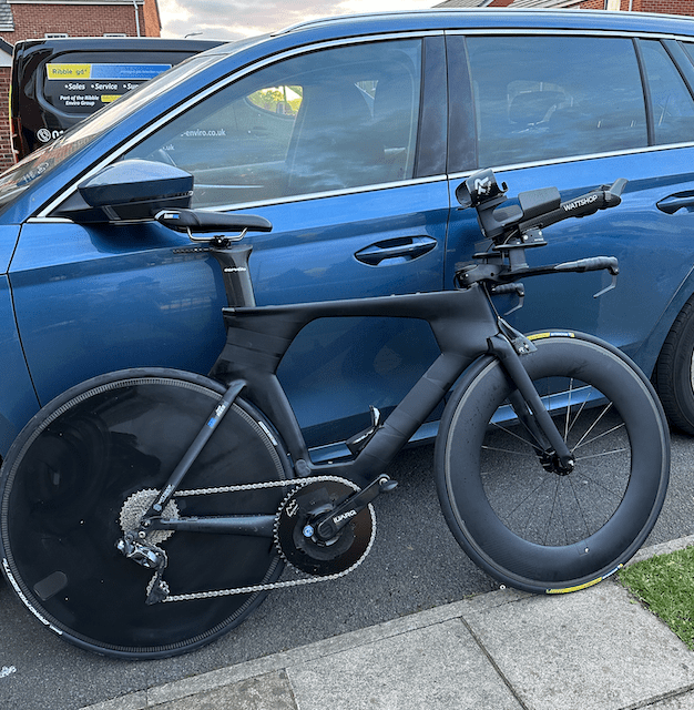

Selcof base bar and Wattshop Anemoi extensions with BTA

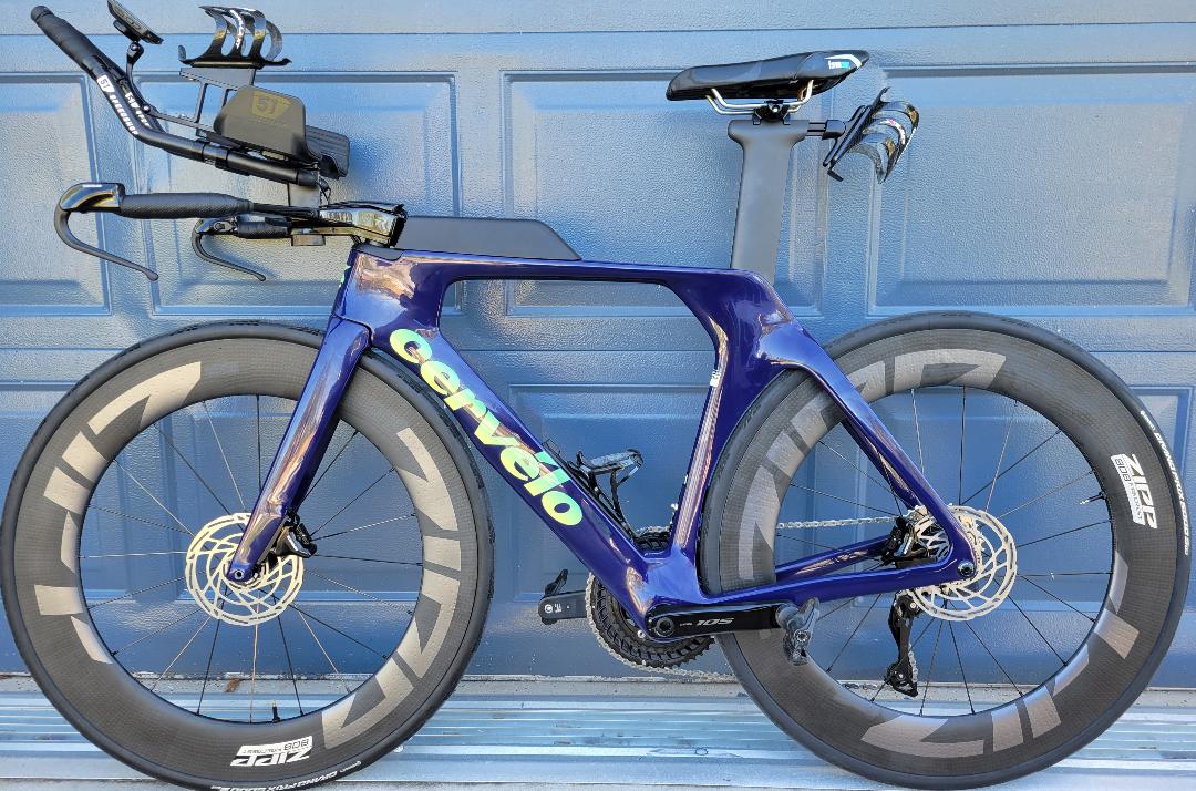

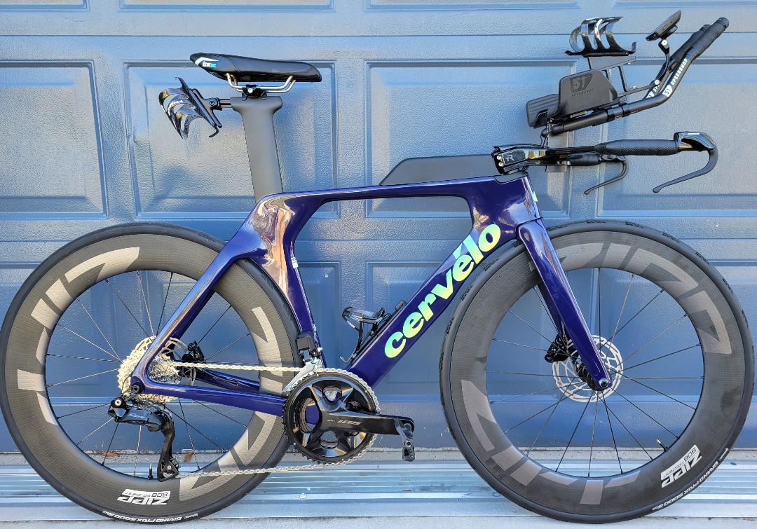

Lots of little modifications to make these bikes faster, last years TT set-up with Vision Snake Bite stem and TFE Pro extensions.

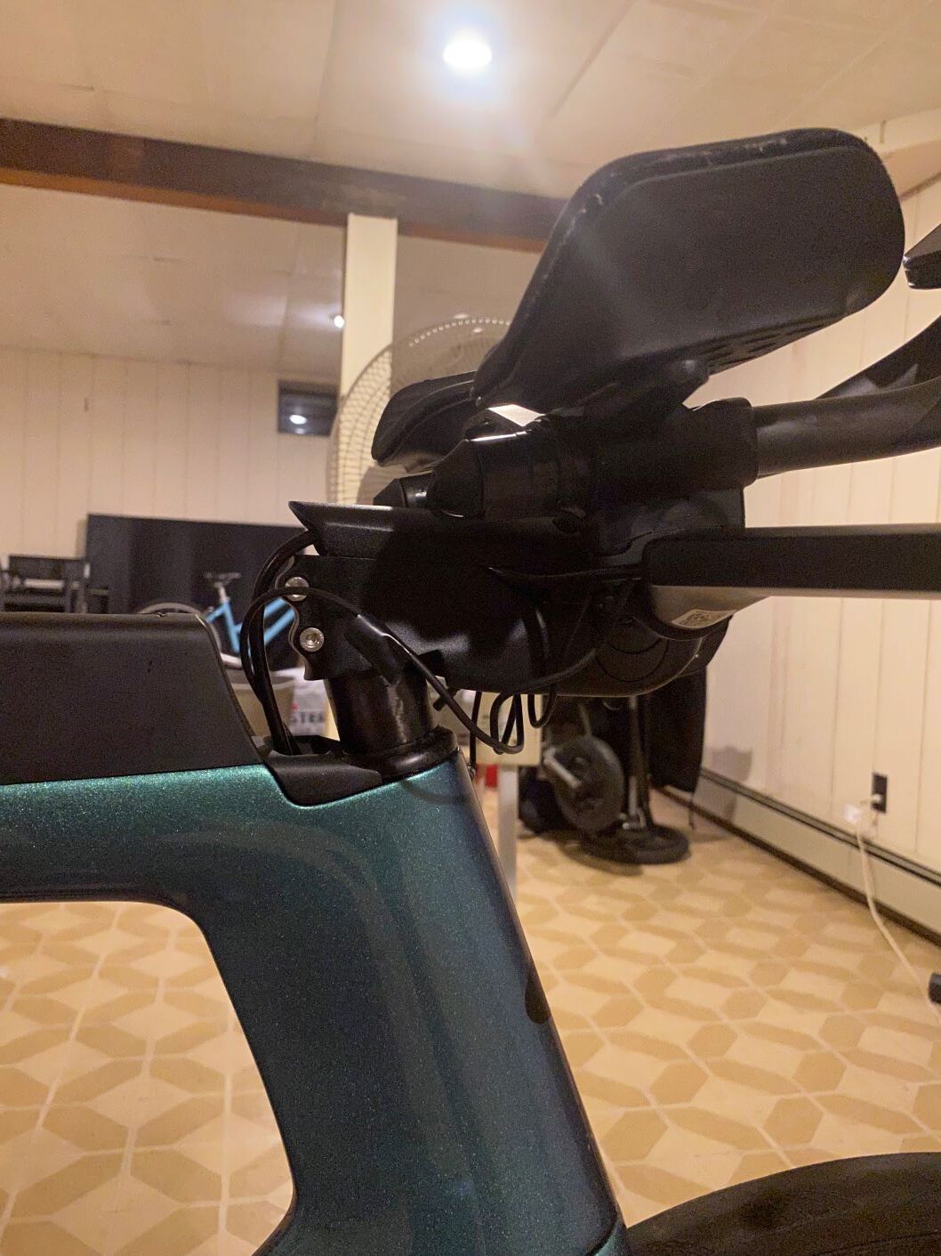

A good option may be the Quintana Roo aero stem. You can route the front brake down the steerer tube and the rear brake through the stem. With a basebar with a center hole at the stem clamp, you can also route the brake cables through the basebar into the stem and then down the frame and fork. You probably need to get the Quintana Roo bento box to match up to the stem. Would probably be a pretty slick set up. I started to investigate this, but decided to go another route. Attached is the Quintana Roo aero stem test fitted on my P-Series.
