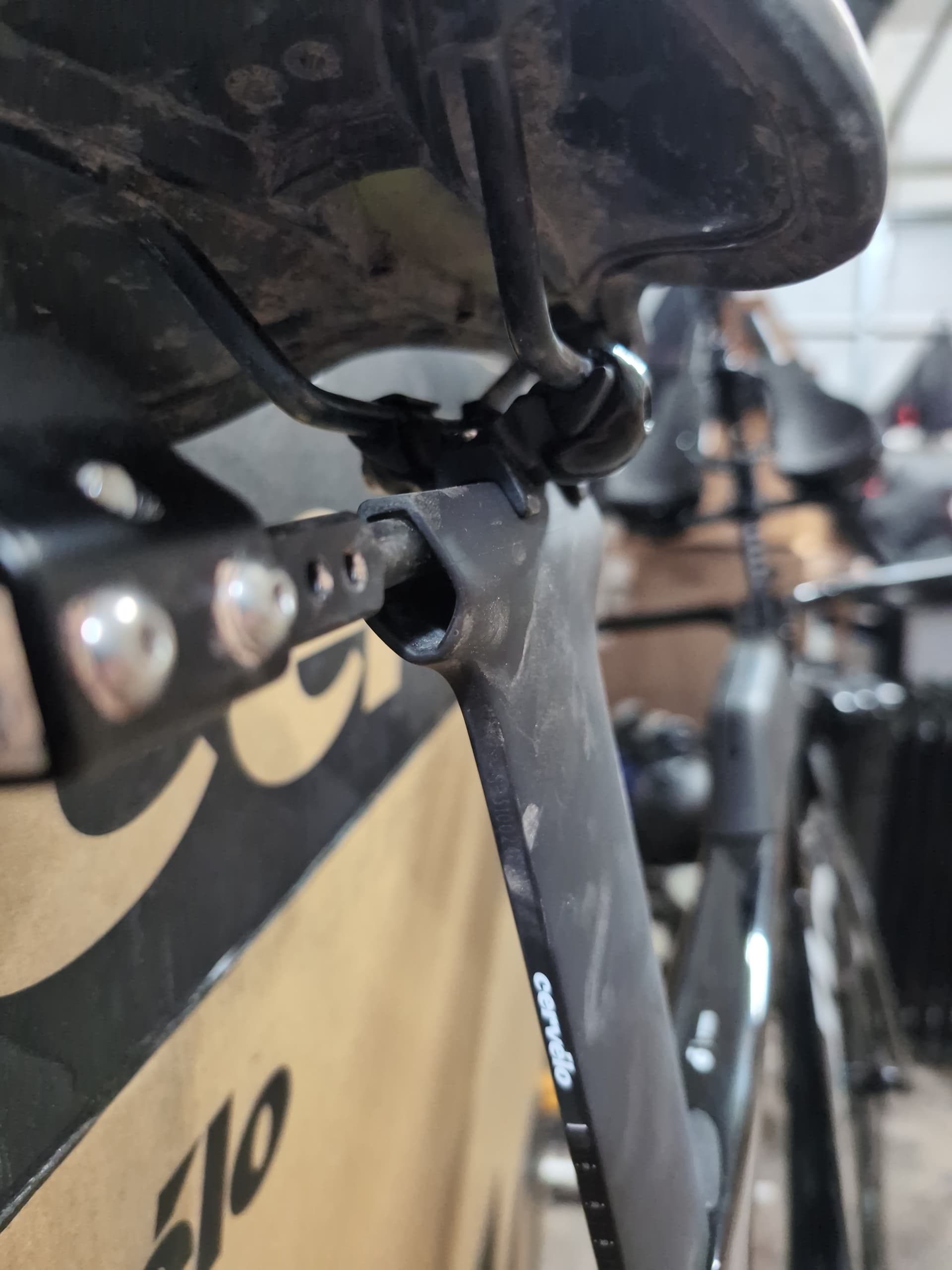

Does anyone know if you are technically allowed to use a round 10mm rail for the saddle rail on a p-series? It’s that style of saddle clamp, but of course cervelo decided to use their own weird shape. I just built one up and I think there was one of these little silver dumbell type parts in the box.
That would seem to imply that you can use a round rail like the TriRig beta carrier. I installed one out of curiousity and while it doesn’t look right, it feels just as sturdy as the stock setup.
Hylix sell a seatpost with a round shape for the P5. I think it is the same for the pseries. i can mesure the size of the hole if needed
