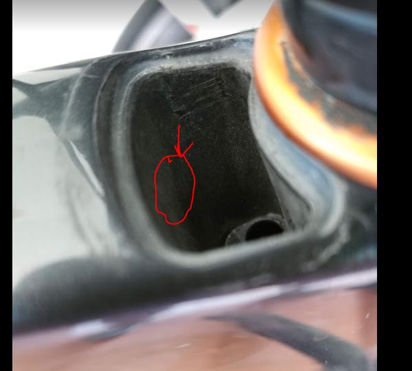

Ohhhh, I see now. Yes it is plastic insert for sure. Like the one in the picture i attached, right? I am assuming that it simply seals off the top tube.

Did the pic post? I can’t see it in my feed…I used one of the small sanding drums/sanding barrel. I went in at a slight angle resulting in an elliptical shape. It was enough for there to be a bit of wiggle room. This helped my braking tremendously. I ran housing all the way to the plastic grommet. Not having the cable flapping around on the left side was worth it for me. GL
I popped out my plastic cable port and used a ~1" cut wheel to create an opening in the bottom-back of the cable port. I removed the fork to help guide the brake hose along the top tube. Cervelo also makes brake cable stops that allow you to pass full length cable housing through the frame (typically for hydraulic hose, but will work with any housing).
Here it is - I draw a red circle around the area that I am planning to make a hole through. Does this look right?
I made my hole in the middle but off-center towards the left makes sense. That should give you a cleaner line to the top tube grommet.
