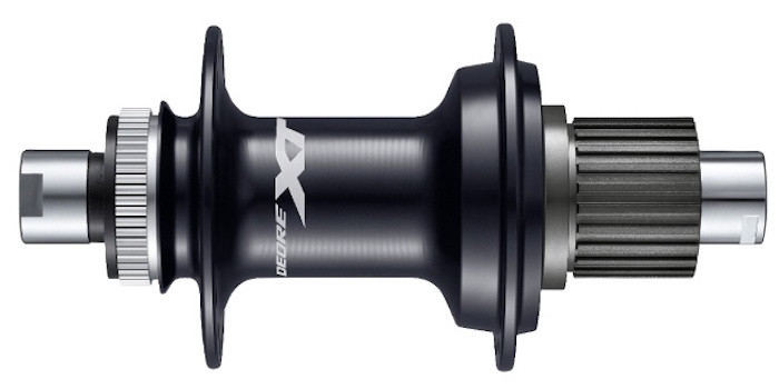

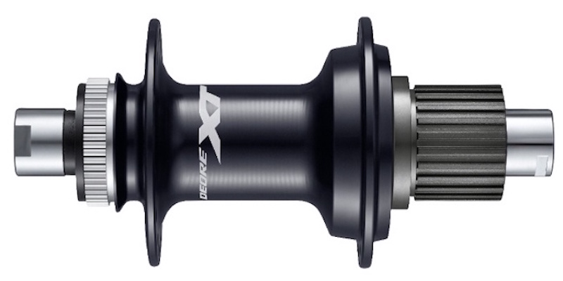

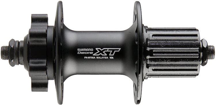

that is an interesting question and though I do not know the answer , when I look at my bike with 6 bolt, it is a solid part of the hub flange on that side, so once the force makes it past the bolt connection it will spread out around the solid flange to hub and spokes, the center lock has a mechanical spline connection that may or may not distribute the force evenly to the hub flange and spokes? So maybe with time and wear the splines may wear and the force may not distribute evenly?
I would love to hear from a mechanical engineer who understands the forces and stresses in the system.
On the majority of hubs I’ve seen, the rotor mount isn’t directly on the flange, but at least a few mm away from it. Usually the hubs with the mount directly on the flange are older or lower end hubs. On most hubs, the hub is stepped down behind the rotor mount to about the same diameter as the center of the hub shell, so there shouldn’t be any significant difference in the stress transmitted to the flange…
