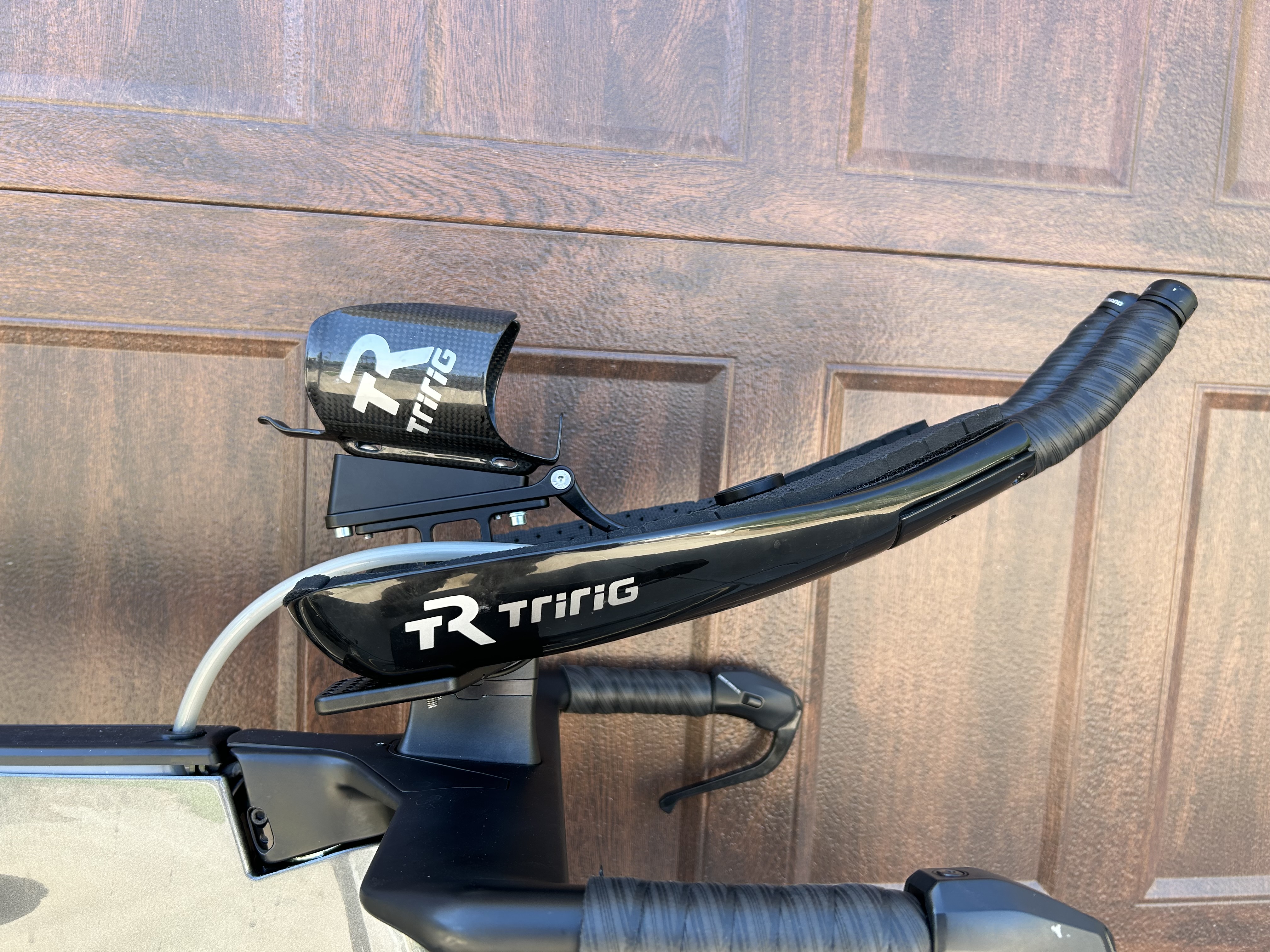

Did you change your front setup? I’m contemplating the Drag2zero or Tririg setup.
I went TriRig.

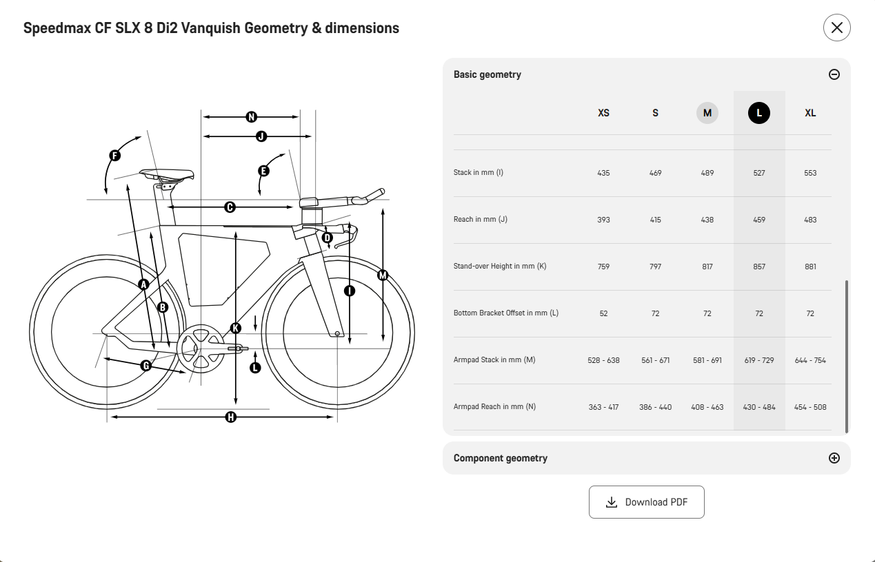

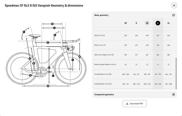

The fit is the biggest difference between these bikes. The Canyon lacks reach. Max pad x on a L frame is 484mm unless you get Canyon to make you some custom parts like the pro’s. On the QR, you could get up to 531mm of pad x. That’s a massive difference (5 cm!!!).

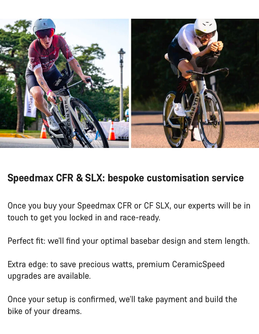

I agree the Speedmax lacks reach, but you don’t need to ask Canyon for custom parts:
  • when ordering a new bike, you can ask for basebar with 2cm longer stem (no added cost)
  • if the above isn’t enough, you can order the reach angled spacer from either of the following: 1) radsport Ibert, 2) speedmetrics, 3) tri-c, 4) fast tt (all 100-200 USD)
Good to know. I didn’t see this mentioned on Canyon’s website. Unless I missed it, seems like a missed opportunity.
That’s pretty vague to be honest.
Seems they should be updating their fit chart to show the full capabilities.
I agree it’s not clearly communicated.
I simply wanted to share with you that this option exists free of charge. You can choose:
  • 85mm (long) vs 65mm (short) stem
  • flat vs risen basebar
  • long vs short monobar extension
  • ceramic speed upgrades for bottom bracket and rear mech
When I was buying in 2022, it was done through a 1o1 conversation with a customer service. Nowadays they built it into the purchase process, but you still have an option to speak with customer service (they might ask you to do some measurements to help you decide).
PS They should be paying me for this :smiley:

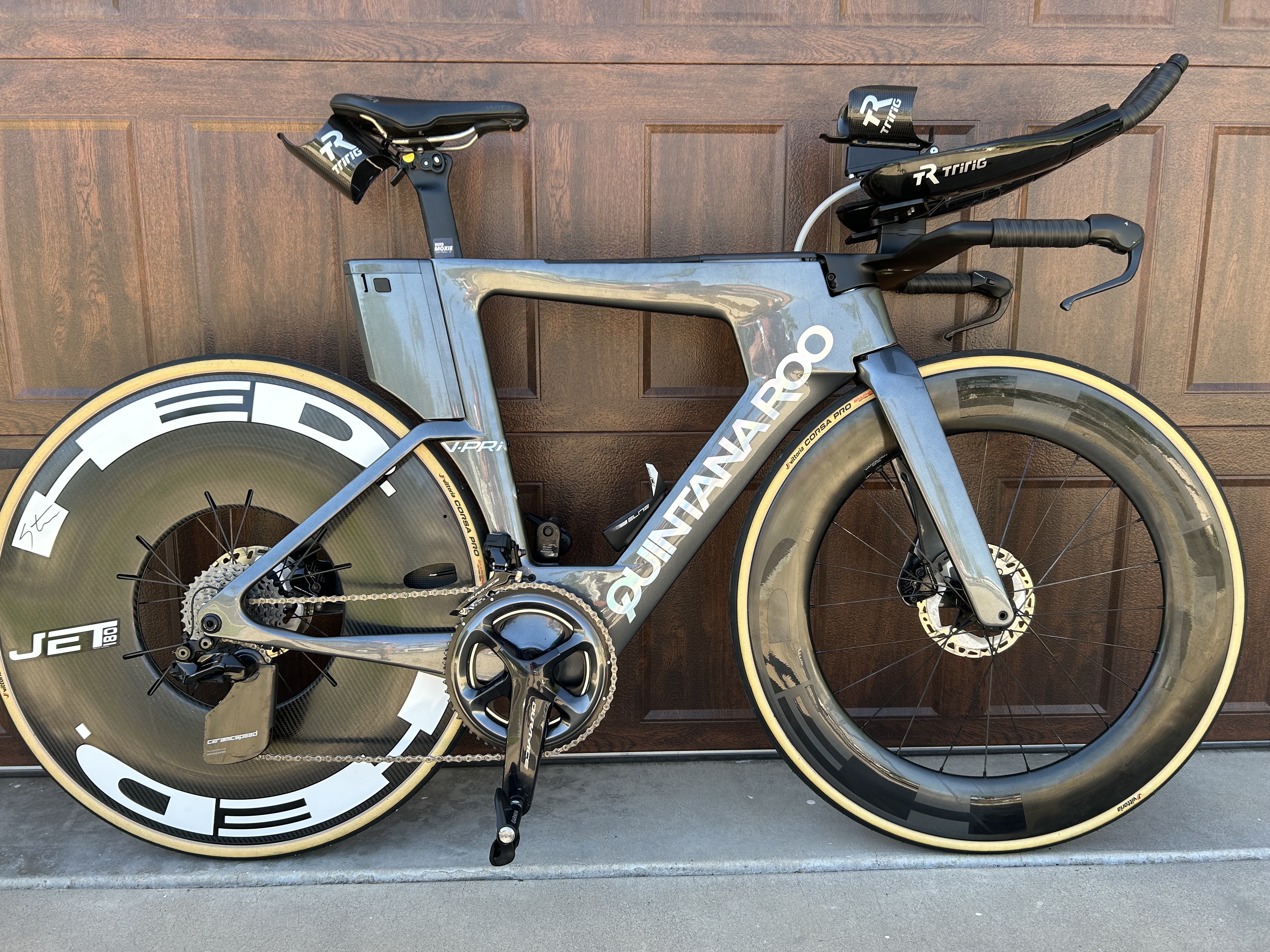

Every time you show this bike…I am very interested in it. Gorgeous build.
Agree, I had to PM Bryan to pick his brain about his handlebar setup. Looks awesome.
