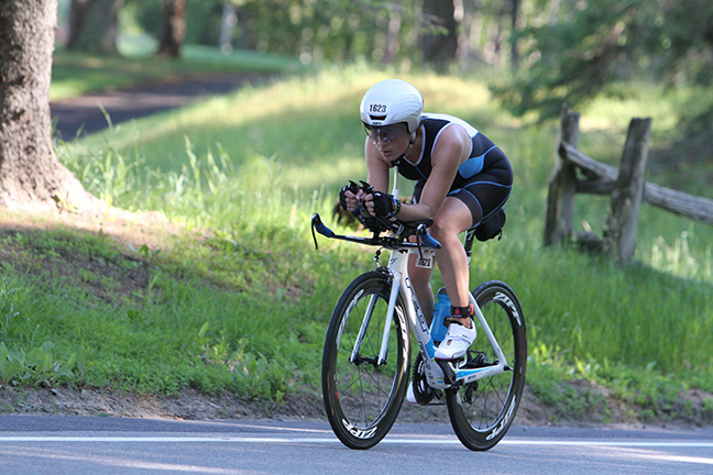

I feel far more stable in the TT position when I can brace against tilted forearms. I felt that it took effort to keep myself back with flat arms, which may be a by-product of a fairly steep seat tube angle, but now I have my forearms raised I just stay put and can focus my energy on spinning pedals round. This was the primary driver for me, with the secondary driver being what folks like Jim have written… it might be more aero, which is a-niiiiiice! And anecdotally I seem to go quickly for the meagre watts I produce.
Not extreme-mantis, however.
https://photos.smugmug.com/Sundowner-Sprint-Tri-2016/2-Bike-Sundowner-Sprint-2016/i-pLdQSXv/0/XL/D4S_2313-XL.jpg
Can you tell me what base bar and extensions you are using?
Yup… older Felt Devox Bayonet, carbon non-UCI ones with the deeper base bar. Use Tula 30 degree alu extensions fitted in reverse. Put the bend near the extension clamps and you can get a good amount of rise.
https://c4.staticflickr.com/9/8308/29796732355_cd12b1a06b_z.jpg
https://c8.staticflickr.com/9/8206/29796726415_f545a25a90_z.jpg
https://c4.staticflickr.com/9/8318/29796736755_e37af7205f_z.jpg
