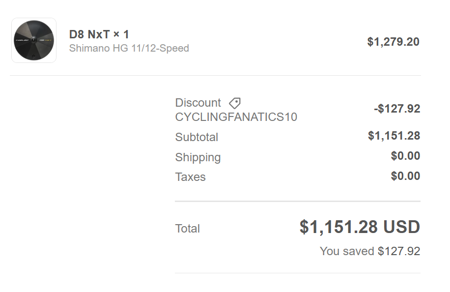

Certainly less post-tariffs. I picked up my D8 Nxt Disc for $1151 but that was pre-tariffs. Looks like list price is now $1599 before any discount codes (but including tariff). Still seems like one of the better bang-for-the-buck options. Only other disc I would consider would be the Scope Artech Disc but the difference between the two is not worth the $3,298 list price for Artech IMHO.
