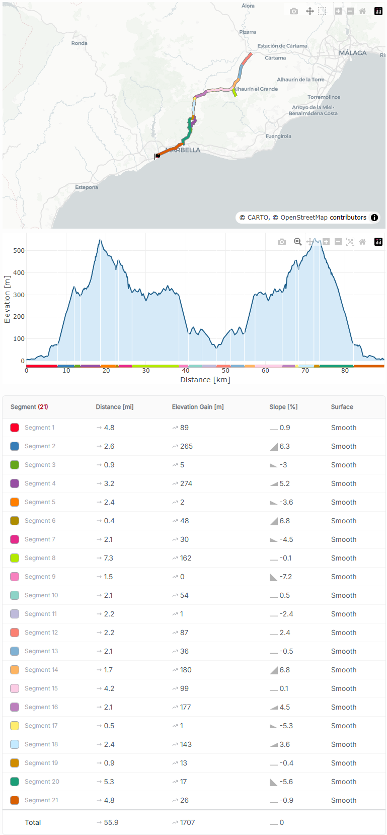

So the reality is more like a 1520m total elevation gain versus close to 1800m? That is a huge difference. Can any locals confirm?
They are not the same course. The WC course for this year has a quick detour off the first main climb that goes through Ojen, but you only do that section on the way out.

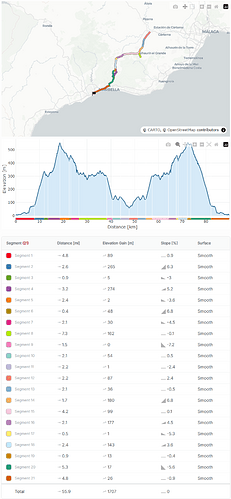

I loaded the correct 2025 WC course into the Swiss Side Performance Platform and it’s giving 1,707m of elevation gain.
Depending what application you load the gpx into and its algorithm, you will get different cumulative climbing totals. I have taken the issued gpx and loaded it into RwGPS. I’ve just done it again and get 1526m AGAIN! (same as 17 days ago)
What @Th4ddy says ref Ojen is correct - see my specific reference to that. The Rouvy route up and down the main road gives 1483m. In November it’s a bit more because (as I describe up thread) athletes lose some height dropping into the village (which splits the climb btw) and that has to be regained (steeper/less graded) climbing out of the village back to the main road.
The SSPP gives more! Choose your weapon!
How on earth would locals know any better? They (may) ride it and their fit loads into whatever app is their preference. My Garmin Connect climbing totals from a ride are very close to the route I’ve plotted during planning on RwGPS. I’ll be there, cheering.
@CoachGlenn says: “I live in Marbella and have done the original course several times. If you have any questions don’t hesitate to connect. I am also an Ironman U certified and Tridot Coach.”
To add colour to my attempted explanation on why people get different amounts of climb for the same route, the Kona course is advertised as 112 miles (180.2km). The supplied gpx shows 180.8km. Ironman say “5814ft” (which 1700+m). From the gpx loaded into RwGPS the climb is 933m but loaded into Openrunner it’s 1611m!
There is a combo of mapping choice and granularity/fractals, and contour counting algorithms at play here.
Ah yes, the coast line paradox. That’s why my bike computer always seems like it’s making random crap up!
Thanks. I assumed the locals may have ridden the old climb not going through Ojen and the new route via Ojen. Whatever, they upload to, they would either see a delta of ~350m (roughly the delta between the old advertised vertical and the new one) or ~40m (which seems to make more sense)
