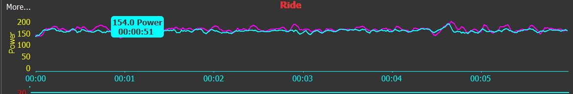

Garmin data…
http://donzo98.easycgi.com/TestImages2/GarminD.JPG
Zwift data
http://donzo98.easycgi.com/TestImages2/ZwiftData.JPG
See post above…

Thanks!!Those plots look like they’re coming from Training Peaks which smooths the data. The slider in the upper left changes the smoothing function but I don’t know if it’s possible to turn it off completely. The smoothing filter will tend to ‘hide’ zeros or dropouts. If it’s possible to post the .fit files I could look at the raw data.

Sorry I guess I’m stumped. The graph below is from one of the intervals. The Zwift data is more variable but I don’t know if that’s being generated by the Neo or from the pedals. What happens with higher power intervals? Do you see the same offset or a similar %?
