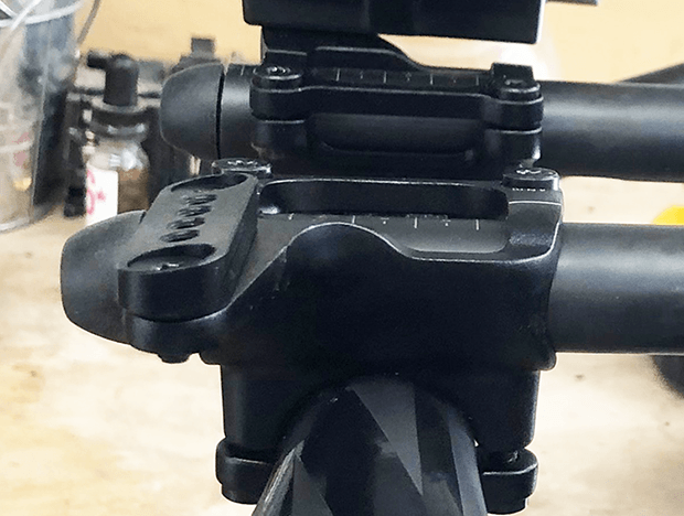

here’s the shape of the extension, with the brains pulled out, and you can see where the battery goes and the 2 ports, 1 of which is populated with the bar-end shifter, the other which can be populated with a multiclic.
here is that bar deployed on the bike i built over the weekend, with the whole system angled to my liking:
i used zipp’s wedge that it makes for use under the armrest cradle in such case you fine that the extension sticks up too high relative to the plane of the armrest.
