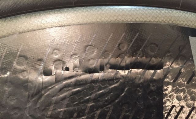

Last Saturday I rode IM Vitoria bike course in preparation for the race (whenever it will be, but that is another story…). I had a brand new Zipp super 9 sitting around waiting for a race to finally happen, so I thought it would be a good idea to give it a try. I setup the wheel tubeless and threw in a 11-28, and was good to go.
I uneventfully rode 135k, and when I came off the bike I found this damage in the disc (see images).
No impact or rub signal, just this carbon failure, looks to me that it is a wheel defect. I contacted the seller and I am now waiting for a reply from Zipp’s rep.
I have no experience with wheel failure, and wonder if the disc is now safe to ride (I’d say it is not). Has any of you seen this happen before? what could be the cause? Do you think it is safe to ride?
In case you are wondering, I am 79kg, ¿174 lbs?, so well within the weight limits :slight_smile:

I’m no expert but that looks rough. More than just whatever the exterior is peeling. I’d stay off until you hear from Zipp.
I don’t think that is structural. I’ll bet it got banged somewhere . . . maybe transition area. So sorry that happened to you.
that looks impact related, but i’d wait to hear from zipp before riding.
Thanks! Fortunately I am in no hurry to ride the wheel, I don’t expect to race until late may at best.

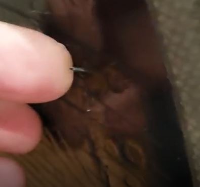

It is structural, I cannot upload the video I made, but I sent a short clip to Zipp where you can see broken carbon fibers, here’s a screen grab:
Gotcha. Again, so sorry to hear about it. I have had many Zipp wheels and never anything like that. I too have a new Super 9 . . . haven’t had the opportunity to use it much yet.
I don’t think an impact was involved:
I was not aware of any impact during the ride (I know I could be wrong), and impacts this strong tend to leave a mark…

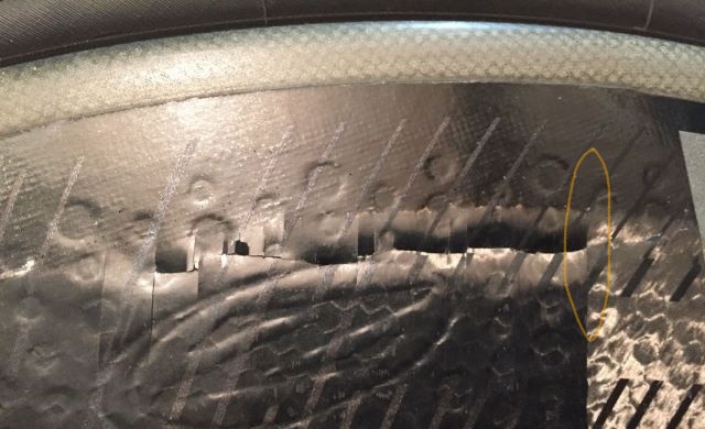

If you look at this pic, the damage seems limited to a particular carbon layer, it suddenly stops where the new layer begins (see the different tone) I’d say that this is not typical of an impact, looks more as a result of stress, and probably due to a faulty carbon layer?
I will not be riding the wheel until Zipp tells me it is safe to ride.
