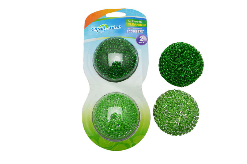

I’ve run the 20 and 30 and I too had some spillage at first. To fix it I went to the $1 Store and got the plastic “scrub pad” and placed it in the bottle after filling. For the refill the liquids can get down into the bottle but the “matrix” of the pad keeps splashing to a minimum. Straw can be routed easily through it as well. I also still used the rubber gasket and refill lid.
http://g01.s.alicdn.com/kf/HTB1c9kOFFXXXXbZaXXXq6xXFXXXS/220937203/HTB1c9kOFFXXXXbZaXXXq6xXFXXXS.jpg
Isn’t this essentially the same thing as the yellow thing that comes with the profile design bottle of old? If so, I already have 2 from those bottles and could use those.
Not sure I never owned those products but if it looks the same I say go for it. I lucked into this as I was cleaning the bottle I dropped it in the sink and noticed that nothing splashed out on me. That sold me to the effectiveness of it!
I use the Aero 30, and I can concur with others who have mentioned that it splashes. And quite badly in my opinion. If you ride on nothing but smooth roads, you’ll be fine with a stock setup. I fixed mine using a similar solution to the scour pads mentioned a couple posts above. I find that it works better than a sponge because it floats (therefore staying as close to the opening as possible), yet doesn’t absorb any fluid. I also have an XLab Torpedo, but with the splashing dealt with, I prefer the Torhans Aero 30 over the Torpedo.
