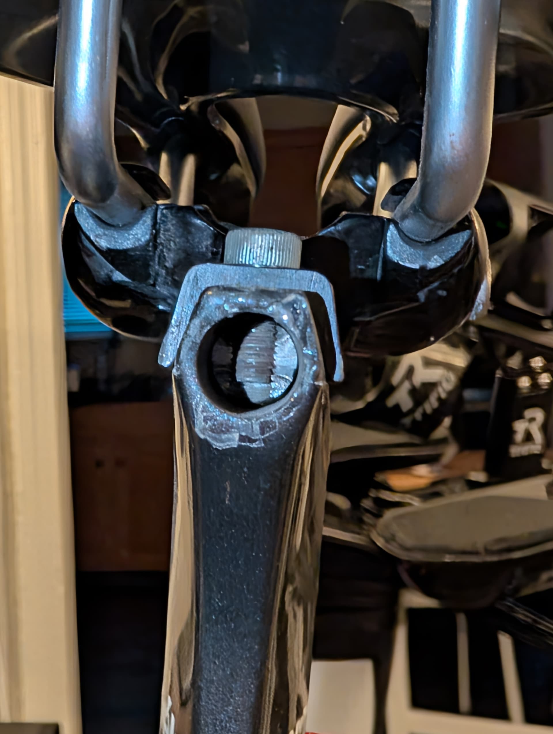

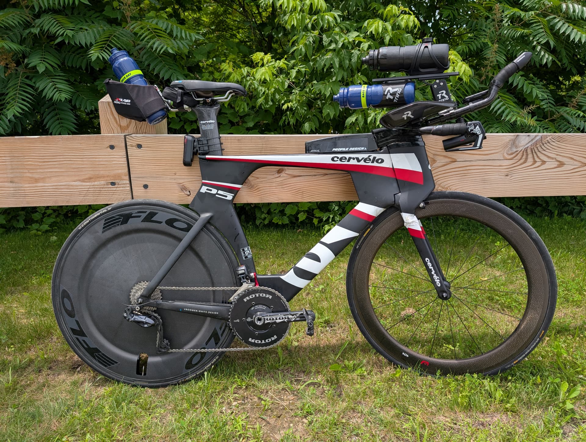

I had a BTS bottle cage mounted to my Cervelo P5 Six with an XLAB Delta Sonic ML rail. Right in the middle of a 70.3 the rail disconnected from the bike & the whole assembly flew off. When I got home I realized that the rail had snapped in half - part of it was still inside the seatpost!
Has anything like this happened to anyone else?
Welcome to the forum. Got any up close photos?
Thanks! I left the cage behind on the course… this is the best photo I could get of the seatpost mount

So we have only found the posts to break if there is an overload of weight on the bar itself and they are more prevalent on Cervelo seatposts.
I can’t remember on the Scott seatposts as it has been a few years since I looked at the back, but on the Cervelo models the material from the top of the hole to the top of the rail is thinner than on other Ritchey rails.
We added a black U-shaped metal clamp to help reinforce the area which we called the Vee Clamp. That definitely helped avoid the breakage.
If you don’t have that Vee Clamp and you have an Aero Pouch 300 I would recommend replacing the pouch with the Multi-Strike option, essentially reducing the weight at the back avoiding a cantilever effect, if at all possible.
