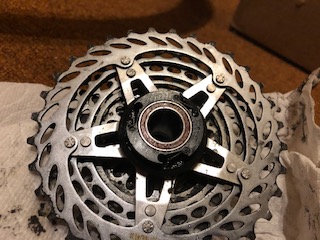

Cassette and carrier that fell off the axle

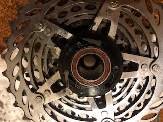

small pieces that fell out

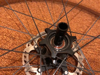

wheel and axle
figured out where the small metal pieces are supposed to go, but am missing one of them. This whole thing fell apart out in the woods, in leaves, dirt and I couldn’t find the other part. I’m actually lucky I even noticed that any of these fell out as they are quite small and since I don’t know much about hubs they weren’t anything I was expecting.
those little things are the pawls. and yes, with some hubs the freehub just slaps back on with very little effort (and comes off with very little effort); it is extremely annoying. you’ll have to get a 3rd pawl if you want that back on correctly, unfortunately.
ETA - there should be a spring, also, i think. once you have all the pawls you slot them where they belong and then rotate the cassette/freehub as you push it back in, allowing the pawls to push down. it makes more sense once you try it
Go find the other pawl and put it back together.
I believe the rubber “seal” holds that in place. Mine was doing that and I cleaned it all up and replaced the seal. It just needs a little lube on the pawls and “tooth area”. You’ll need to find another pawl.
Just disassembled another hub…there are a rubber seal, 3 pawls and one round string spring which holds the pawls into place. Wasn’t a zipp but to get an idea.

Looking at the photos the 3 springs (1 per pawl) are still in place. They are like leaf sorings and push the pawl out.
When you refer to on round 'string spring, I think you’re talking about a single loop about 40mm diameter ish made from thin (0.8mm ish at a guess) wire ? Is that right ? If so the hub in the photo won’t have one of those- what you describe is what Fulcrum and Campag use instead of the 3 separate pawl springs (sitting in a groove in the pawls to ‘rock’ them outwards (bit of a shiiite design from Campag that saves 2 grams and introduces a single point failure that leaves you stranded).

I didn’t see any spring, but the individual pawls interfaced with a “leaf spring” in the recessed spot where they fit into the cassette carrier assembly. Unfortunately the other pawl is missing somewhere in the wood, maybe I will take a trip out to see if I can possibly find it. Looking online, you can buy the whole cassette carrier/pawl/bearing assembly as a replacement part (it is like $100), but not individual pawls.
Based on responses here and looking at schematics of the hub online it seems like if I just had that pawl I could just put the whole thing back together and it should be fine. Lesson learned, I guess be careful when I have the wheel off and never set the wheel cassette side down, especially when you are out in the woods changing a flat.
You can buy a new set of pawls, do a search for Zipp 177 Freehub Pawls, I think a set cost like $25 or so when I had to replace mine. Buy another one or two of the rubber seals that go with it.
When assembling it, put the pawls and leaf springs as they are supposed to go, roll the rubber seal half way down holding the pawls down. Once the pawls are held in place, then continue to insert the freehub in place. If you force it or try to rotate it back a little as some others it won’t work.
