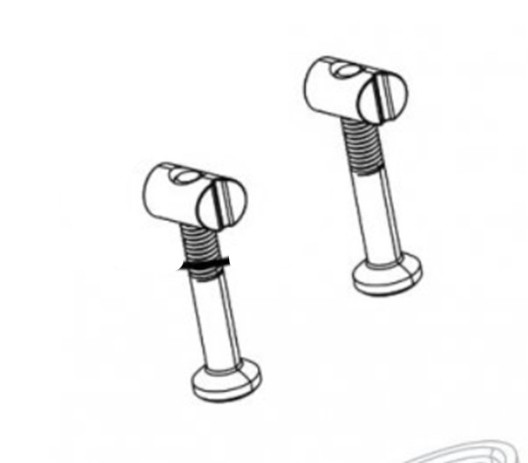

I’m looking for barrel nuts that help clamp the arm rests/risers to the Zipp Vuka Aero Integrated bar. If you have spares (Qty 2 min) please let me know. I’ll take the 25 or 30 mm bolts as well. Greatly appreciated!

Thanks. But, I don’t think McMaster-Carr sells metric dowel nuts. I think the Zipps are M5 X 8 X 12.
I had to buy some recently, I contacted Zipp and they gave me the part number below. The cost wasn’t too much. I searched the net and it looks like the part number may have changed bc most are out of stock.
11.6618.029.002 HANDLEBAR VUKA AERO C1 TOWER BOLT KIT (4x35MM INCLUDING NUTS)

I was given **11.6618.019.000 - **HANDLEBAR VUKA AERO EXTENSION TOWER BOLT KIT from SRAM.

Thank you for the info! I saw them as well and thought I lucked out. Unfortunately, I they’re M6…Zipp’s are M5.
