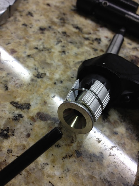

…and now the photos. I hadn’t looked at these since taking them last night, and I gotta say they may garner some awards. Truly outstanding photography. Enjoy this compelling photo expose’
1: The enigmatic metal cap:

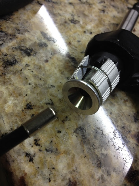

2: the sleeve with the cap, with an amorous eye toward the seemingly-willing shifter aperature…

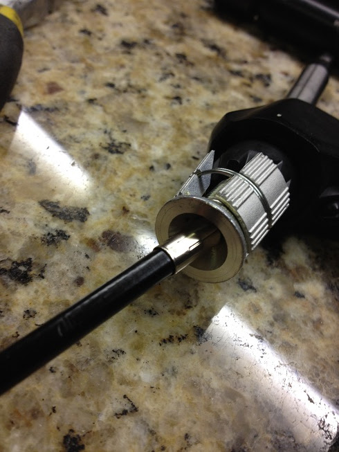

3: REJECTED AT THE HOLE!!! it’s just not gonna fit folks.

Thanks guys… I guess what I really need to know is… do you guys have those caps on and, if so, are they magically fitting into that shifter hole nicely, or does it just mean the cable sleeve ends up not going into the shifter housing at all and the metal cap just bangs up against the outside of the shifter rear?

No cap into shifter.
You do not need the ferrule on the end of the brake cable that goes into the brake caliper or shifter - though it’s a neater finish and the cable (depending on the shifter brand) may seat better in the shifter. But the most critical element is the cable goes all the way into the shifter and the brake caliper. You must have ferrules on both ends of your shifter cable.

Perullo, in this case, the “outer casing holder” is simply where the cable housing fits into the lever assembly, it is not the ferrule. As you found out, using a ferrule will prevent the housing from seating all the way. Bottom line, don’t use a ferrule on those levers. (and always use a 4mm ferrule for the shifter housing where it seats into the bar end shifter.)
No, but its nice to have.
if they fit use them.
if they dont, you dont need those stupid caps. they just minimize the hole where the cable exits and also helps the cable to be centered upon its exit.
the system is sealed at that portion and the brake lever centers the cable itself.
