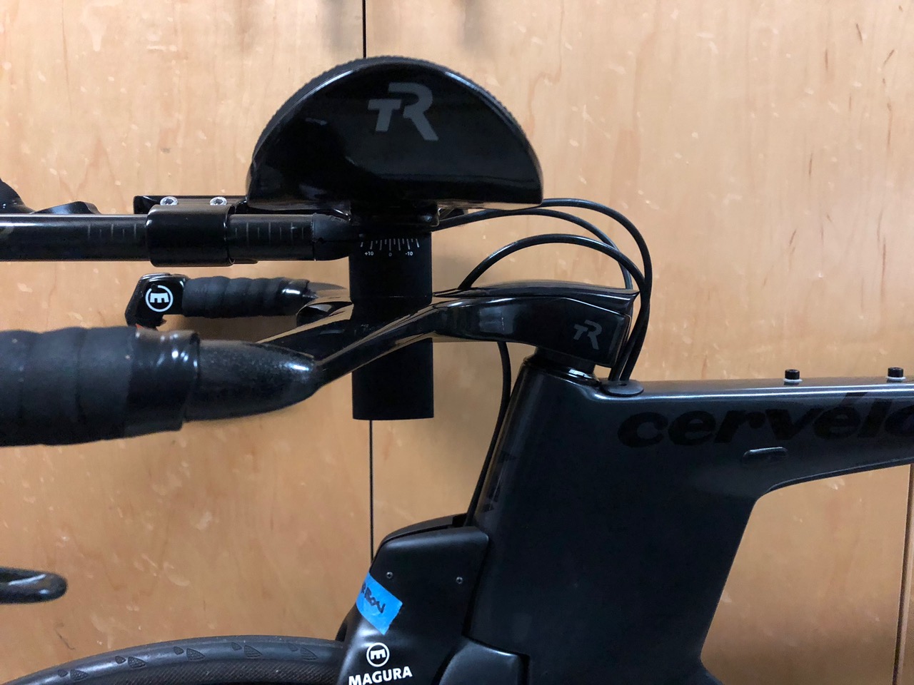

I’m running Dura-Ace mechanical and Magura hydraulic brakes on my P3, and making the move to TriRig’s Alpha One cockpit.
As you can see, my LBS routed the cables outside of the stem cover. The mechanic felt the angles necessary to route the cables through the cover into the frame would impair shifting. That is obviously unacceptable!
TriRig has been very responsive and helpful throughout my selection process, and recommends re-routing the shifter cables OUTSIDE the extensions. The idea is to hide them under the bar tape, securing them to the extensions with electrical tape and creating a clean path to get into the port in the cable cover.
Anyone got an opinion on that?
Better ideas?
Input welcome,
Scott
I think you’re in a pickle trying to get the cables out the back of the stem cover then immediately turned 90 degrees down into the port in the frame.
As a possible solution I’m envisaging an inline pulley arrangement behind the stem, something like an Avid rollamajig, Problem Solver Travel Agent, etc, but looping up and over through 270 degrees not 90 degrees.
At the front end, maybe a sleeve of heatshrink would be neater than electrical tape? Exit the cable at about the extension clamp and it should have enough bend to tuck under the stem cover. Either that or slot a hole in your extensions, if you dare…
(I would imagine the aero penalty of doing this would probably be more than just the bare cables as they are now…)

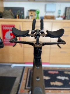

I ended up going all in with Di2. If you think the pic above is clean, you’ll love the final look. I can post some pics when I get back home.
There were some hiccups along the way, but the final result is very clean. I recall getting the junction box into the stem cavity required some modification, and picking the right cables is an art form with a learning curve. I could dig up my notes on all that if you go that direction.

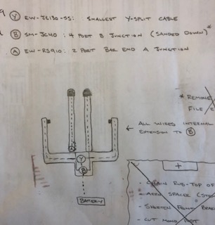

Here is a schematic of my setup along with some pics of the final build. Rear brake cable (hydraulic) exits the stem and routes through the top tube.
Wow nice work! Very Clean!
