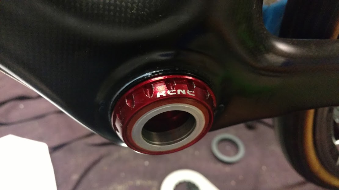

I had a Felt F1 PR that used the same BB30 and spindle reducer setup with an Ultegra 6800 crankset. Bearings were starting to make noise so I ended up replacing that setup with a KCNC thread together bottom bracket:
https://www.enduroforkseals.com/products/bottom-brackets/road/bb30/24x24/BB30XHT2-KCNC-RD-CS.html
Installation was fairly simple and it worked great. Felt smooth and no creaking. I can’t comment on longevity however as I no longer have the bike.
