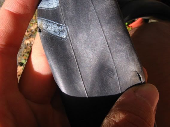

Another teletale sign is the the holes look like a cut vs. a hole. The pic below is a classic pinch flat.
http://2.bp.blogspot.com/-Mu_snGTo_VQ/Ty4H8QLIiOI/AAAAAAAAAs4/DOQxuD8mJAs/s320/image004.jpg
In this pic, the hole on the right is a single-side pinch flat. The one on the left is a puncture flat.
http://i105.photobucket.com/albums/m204/Todd_ME/bike%20repair/BikeRepairsOctober162006003.jpg
