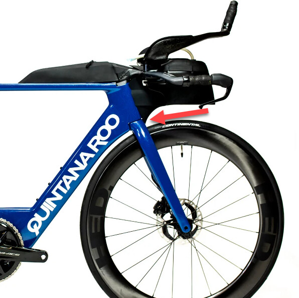

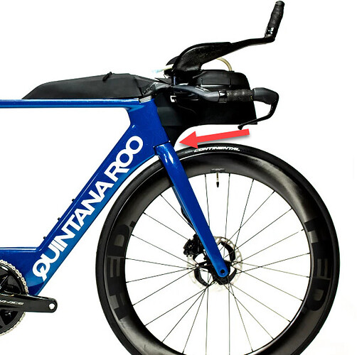

I’m just gonna roll with this setup for St. George, but I don’t have a great many options when Ironman starts enforcing this. If I replace the elevator with the basic riser and angled spacers, and maybe reduce the angle of the handlebars to bring up the ends of the arm scoops, I might get the 2 cm I need. But I really don’t want to mess with my fit just to make it work, so I’ll probably just go back to a basic one BTA bottle setup.

So is it correct to take this to mean QR’s filler block on their version of the Aeria hydration will become illegal (definitely less than 20 mm above the tire).
