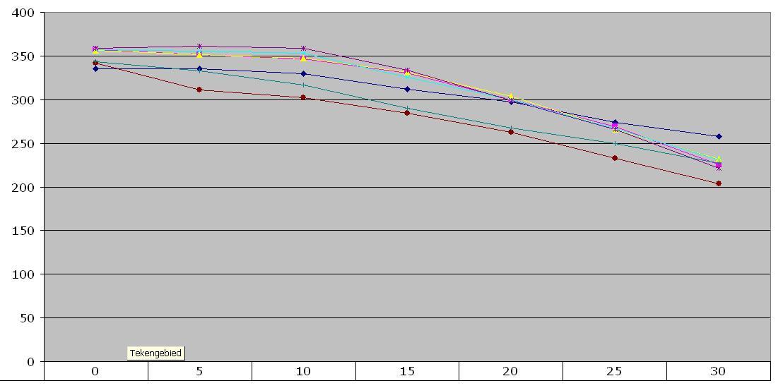

Color me confused: the lines represent changes from the baseline position at various angles–but how does the baseline position do at different yaw angles? Wouldn’t it make more sense just to put up the numbers for all of the various positions in total drag? (of course, that would probably be giving out too much info…).
Secondly, what’s the prognosis for putting out full power? Are 2 and 8 positions that could be tolerated for an all-out 3:3X-3:4X effort? Personally, I find it harder to reach full power over that distance than over 40K. Obviously, faster is faster and all. I’m just wandering if 2 and 8 are ‘windtunnel’ positions that can’t be sustained?

well…not necessarly… i just dont understand why post the graph without the positions? i dont know what it tells? but maybe some other understand and i m fine with all this… i m just asking andrew to post the pic if he can…that would make the thread freaking super interesting! or maybe just help me understand more!!!

Well, I’m not that smart, but there are a couple of unusual things I notice: the relative standings of the different positions completely re-arrange themselves between 0 and 5 degrees. You’ve even got a couple of lines that cross each other 3 times between 0 and 10 degrees. Only one of the positions yields anything close to a monotonic increase in drag. I’m not happy about this, because it suggests 0-yaw field testing isn’t all that useful.
This is a great deal different from the graphs of wheels from Zipp and Tour mag, in which the lines tend to run parallel to each other; a few may cross once (though these tend to be ones that are very close to begin with).
It also suggests that wind tunnel measurements taken at a fixed, non-zero yaw don’t tell you everything either, huh? Hmm…who’s been telling us this all along??
It’s sounding more and more to me like the most useful field test method is the “Chung method” where you use a loop type course and have some wind present and your speed is varied. That way, at least you get an “average” CdA over a range of yaws instead of just a single zero yaw number.
