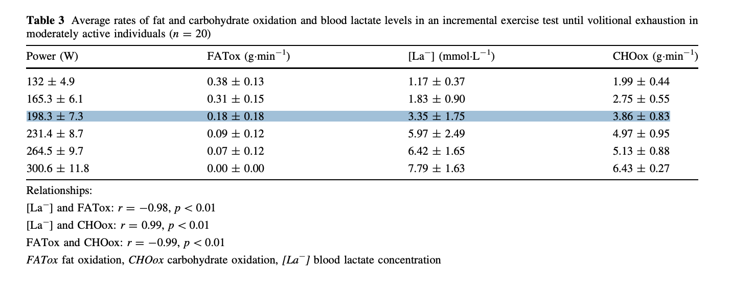

Dr. Sampson points to a recent study that looks at carbohydrate use in both professional and amateur cyclists. Athletes performed a VO2 max test, and their data was collected including power output, gas exchange and lactate to determine which fuel source, fat or carbohydrate, their body was using throughout the test.
“In a cycling context, typically when athletes are expending between 80 to 100% of their VO2 max, they can be burning between 4 to 6 g of carbs per minute,” she says. “I’ve seen hundreds of athletes’ data and observed a similar pattern that, when racing around what people define as FTP, they are burning around 800 to 900 kcal per hour, almost exclusively from carbohydrate.”
“If we look at the data from this metabolic flexibility study, when an amateur is riding 300 watts, they are relying 100% on carbohydrates as fuel, burning around 6.4g of carbs per minute – that’s 386g carbs per hour!” she continues. “The same 300 watts can feel much easier for a pro. They’re still burning 254 g of carbs per hour (4.2 g/min), but they are also still getting a small amount of energy from fats, about 25 g per hour (0.42 g/min) because the intensity is easier for them. But if a pro was racing at 400 watts, they’d be burning the same 382 g carbs per hour (6.4 g/min) that the amateur was.”

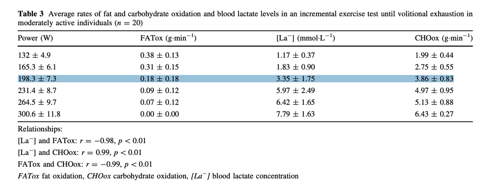

This study is actually kind of ridiculous, the “moderately active individuals” are burning 4g of carbs per minute at 198w?! That is absurd to me. 960kcal per hour just from carbs at < 200w. :rofl:
Yeah, something’s off. They have the total kcal burn for 198W as 1024kcal…so approx 1024Kj/hr for 198W. Should be more like 280W.
