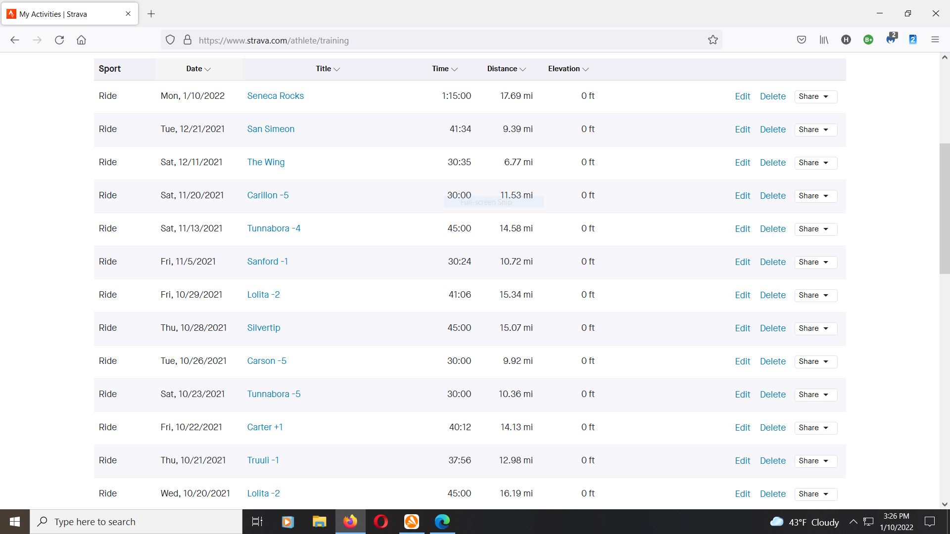

For years I have been using Tacx Vortex smart trainer. I typically use the Trainer Road Tacx Cycling apps. Last month I purchased a Tacx Flux S smart trainer. I have not used the Flux much due to focusing on running but the few workouts I have done on the Flux are much much more challenging. The Trainer Road and Tacx Cycling settings have not changed. I realize that speed does not mean much, but my trainer speeds have dropped from about 19/20 mph on the Vortex to 14/15 mph on the Flux. December is the first workout on the Flux, the previous on the Vortex:

Are you riding your workouts on the same gear between both trainers? And, are you using ERG mode?
In ERG mode, the speed is solely driven by the gear you choose. For the same workout on the same trainer, you could ride the same effort but go 12 MPH or 35 MPH just by selecting a different gear and changing nothing else. Same effort.
The accuracy on the vortex sucks compared to a direct drive trainer.
Same bike, same gears, similar courses (typically flat to slightly rolling), same settings, calibrated prior to each workout. Different trainer: Vortex is a wheel on trainer and the Flux is a wheel off trainer.
That vortex is both inaccurate is does poorly at holding constant as it heats up. Your new unit will serve you better, dial the workouts back a bit
P1/T1 = P2/T2
If you start with a certain tire pressure P1 at the start of your workout at a given temp in Kelvin (T1), by end of workout your tire with the same volume has a new temperature of T2. This means the pressure on the wheel on contact point P2 = P1 *T2/T1. It is not "nothing. If tire temp was 20C or 293 Kelvin at start, and end up at 30C or 303 Kelvin at the end, now your new pressure is 303/293 of your original pressure on the wheel on part.
Your direct drive trainer removes all that.
Keep in mind that your calibration rolldown test iteself my be flawed and give you too high a score to start with which implicitly gives you too much “wattage credit” starting the ride and even though the pressure goes up by end of ride bringing the actual wattage closer to reality, it may not be enough to offset the too high roll down calibration “credit” factor.
