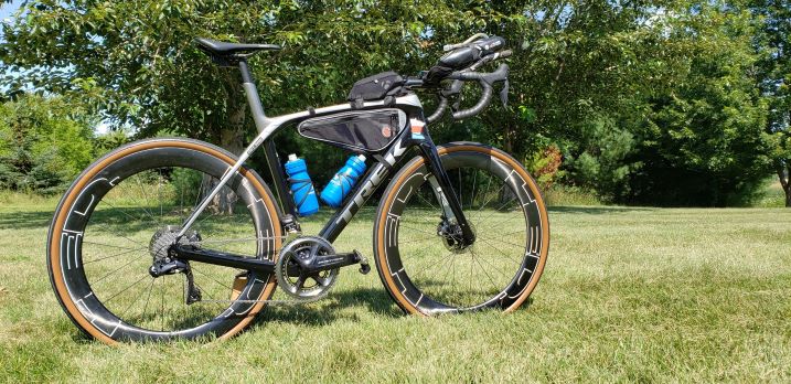

I care! A lot. Here’s my Gravel Worlds setup.

If racing in a group I think if anything the bars might be slower. See my pic above. That bottle is always in the wind if not down riding in the bars. Same with the bars them self. If I can spend 50% of the time in the bars what are they doing the other 50% of the time? They certainly aren’t making me faster when they are being unused.
