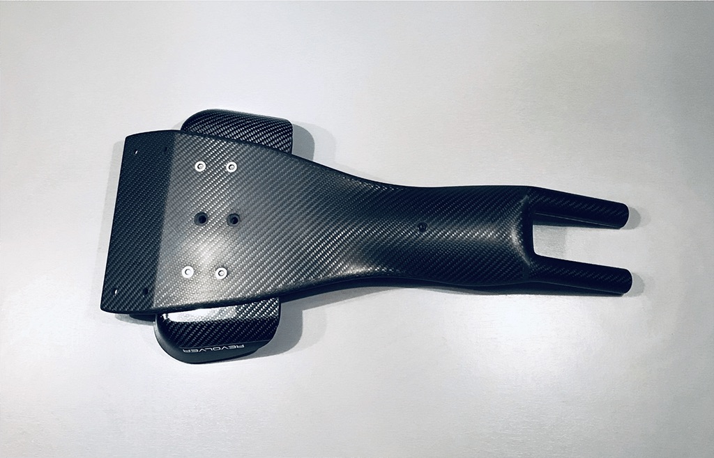

Who's tested mono aerobars? (one piece rather than two extensions)
I see there’s been a thread on here about ‘filling’ the gap between aerobars using tape, foam matting etc. And there were suggestions that this hack may not be any more aero than leaving the cockpit alone. But what do people make of the mono-bars (correct me if I’m using the wrong term) used by the likes of Frodeno, Skipper, Ryf, Luis etc – have any of you tested them? Is it faster than having a super-extension of the likes of Speedbar? I guess the answer could easily be: it depends. But thought I’d ask anyway.

Brining this back up ahead of Kona. Where we will see some big snow shovels in use.

I have tested it twice on real setups. Both times it was uber marginal. Once a tie, once the monobar lost. But it was really small.
I have tunnel results from a third pro, no difference.
Also twice I tried home made solutions like Sam Laidlow electrical tape and other “gimmicks” and it never tested faster.
Speaking to a custom bar manufacturer, they were skeptical.
My instinct tells me it’s uber marginal. If someone is giving it to you, no harm, possibly some comfort. Personally I wouldn’t fork out $$ for it.
I’m surprised, I thought it would be significant. I think canyon testing showed a significant improvement in it’s tunnel for Lionel ? Not certain but I also recall Anne Haug and Sam Laidlow claimed high gains also
I am more in tune with Lionel’s numbers (or was) than Anne or Sam. Walk through his videos and you can see where he made the big improvements. Combine this with his previous tunnel and road tests and I’m not sure the bars were game changers.
Let me put it this way, take where a person ‘is’, look at all the changes that could result in aero gains and sort them by the probability of impact. The monobar IMO goes towards the bottom of the list. However when you’ve test, the actualy order will change.
Just to clarify, are you saying the difference in mono riser vs dual riser is marginal or the difference between a “snow shovel" mono piece cockpit vs dual extension with a gap is marginal?
Or both?
Snow shovel vs dual extension
