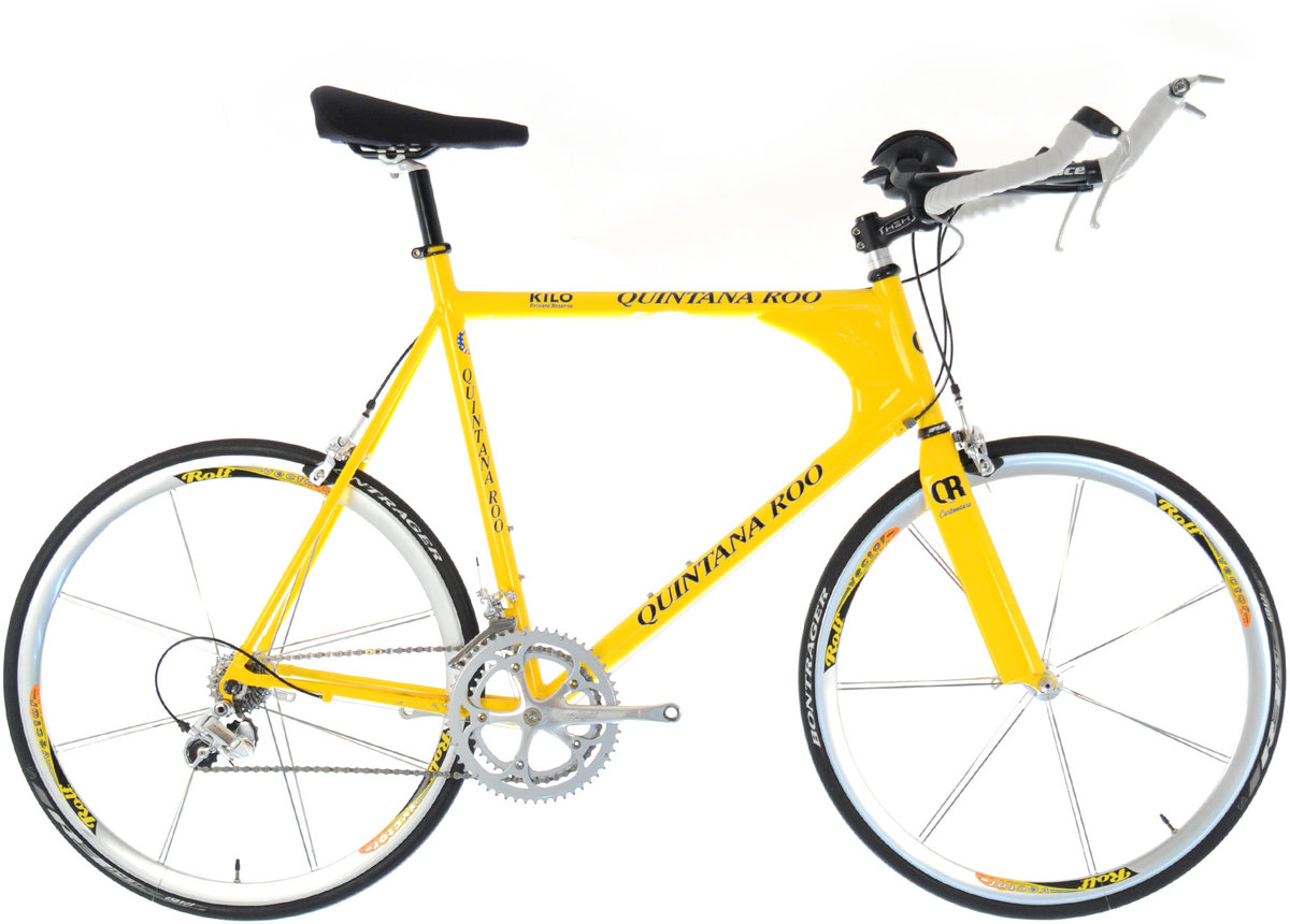

The smaller wheels were lighter and accelerated more quickly, but the rolling resistance was higher and they were marginally less aero (the wheel is smaller, but needs to spin faster since the speed at the outer diameter is the same regardless of wheel size).
Ironically, many tri bikes tried 650c wheels (Dave Scott was a big proponent, and QR was also on board) when the acceleration/weight benefits would have suited roadies far more (I think Alano used a 650c bike for some climbing races, but they never really got any traction in the pro peloton). 650c wheels also helped smaller riders get better fits and not have front wheel/shoe overlap.

Dave scott ironman bike mentioned earlier came in a 650c front/700c back for smaller size fitting and steering…was the name for that type of format a terry?
I had a 650c cannondale tri bike, it felt fast, but at 62cm frame, it felt hairy in fast sharp corners or hitting potholes. 700c definately has handling confidence. Now that tyres are 5mm wider that might be less of a factor with a smaller radius front wheel?
Terry did a lot of 650c front wheel bikes to help fit smaller riders.
Not sure if there was a standard industry term for the 650F/700R bikes. The “funny bikes” were typically 24"F/700cR, and had cowhorn bars (ex. the Shogun Kaze…sold in the mid-80s as a triathon/TT bike).
Not buying that they’re less aero. The top of the tyre will be going twice the speed of the bike, regardless of size.
There would be slightly (very slightly) more drag from spinning the wheel bearings faster as well as the smaller diameter tyre interacting with the ground, but it would be small indeed.
Regarding 650 wheels, my understanding is that the main objection to them among the pros was that the neutral support mechanics that were on the course during the big races didn’t carry them. The same issue now exists with the competitors having to standardize their brake configurations.
That’s why I said marginally. I can’t find the tests, but the results surprised most of us at the time since we just assumed smaller wheels would be MORE aero. PNF’s success on 24” wheels also fed into this assumption.
Steve Hed even made a bike with 20” wheels as a prototype based on that assumption (looked oddly like a folding commuter bike).
If I remember well, the smaller wheels had more rolling drag, not more aero drag
