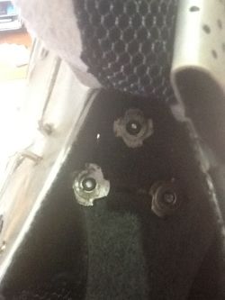

yep - don’t have any pics though. The original holes had metal threads inset into the sole. I placed star nuts inside the shoe so that the cleat bolts were placing a compression force on the sole (no risk of delaminating). I’ve done the same with another set of Bont’s - Bont actual do the orginal drilling with star nuts inside the shoes, so I just drilled a second set of holes further back and moved the star nuts.

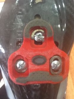

I use Looks and just move the cleats back by drilling a second set of holes in the soles. Depending on the sole you may not be able to get a midfoot mount, but I have been able to move cleats 25mm further back on 3 sets of different shoes. I have never seen an adapter plate for Looks.

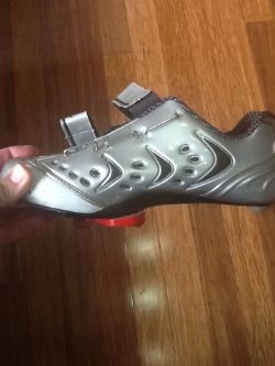

Curve of the sole and narrowing of the sole under the arch prevents the cleat from being moved further back on these shoes. I also have a set of Bonts (not pictured) that have a much flatter, wider sole that would be suitable for a midfoot mount http://i1285.photobucket.com/albums/a597/nickag1/dee47cffa137fa375aeac60752a09663_zps254d01ac.jpg
You can see the original holes just above the cleats. The cleat overhangs the inside of the sole by about 10mm (this is the right shoe).

Not visible from photo, but the star/T nut protrudes into the shoe, the insole goes over the nuts and covers them up so doesn’t cause me any problems.
