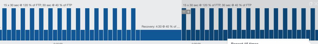

I’m looking at a workout from a training plan. The workout has two “sets”. Each set has 15 intervals. Each interval is 30" at 120% of FTP followed by 30" rest. The total workout would have two of these sets for a total of thirty short intervals.

I’m not sure that I get the idea behind the first workout. Why so many 30" intervals?
