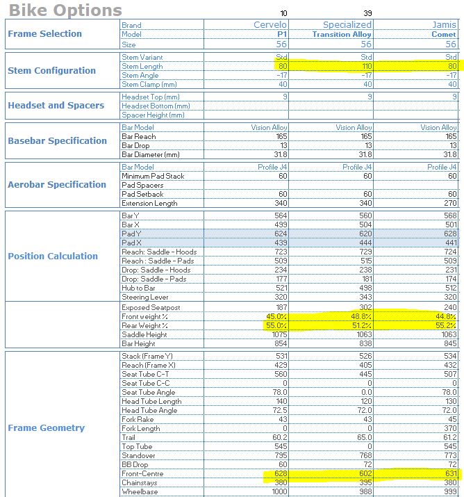

My stack / reach is 520 / 420. Or pad s/r of 620 /485. The 56cm transition is 526 /405. See above for my thoughts on STA and cranks.
I already have my saddle (ism pr2.0), and current bars (ozero, and t2+). I also have sram red shifters, RD, FD, and brake levers. I have my wheels. So really in the case of the transition, it’s just the frame, crankset and brakes.
I was already looking at the zip vuka, and might go undermount to assist with pad stack if needed. But, I think the bigger question is reach… Longer stem or more forward pad placement.

I work to rear of the pad for pad X so have used 445 as the target
If you’re looking at 56s you will need low stack aerobars - either undermount or the new Profile Design Subsonic (I designed that bar so may be biased)
You can hit current number (just) with an overmount bar, but getting a TT frame should allow you to adapt your position lower over time - so you will need adjustment room.
You can see that the Transition alloy has a lot less front centre and this has a big impact on weight distribution. I found the Transition to be quite twitchy as a consequence.
The aero shaping of the Transition is OK, nothing exceptional. P1 much more advanced in that respect.

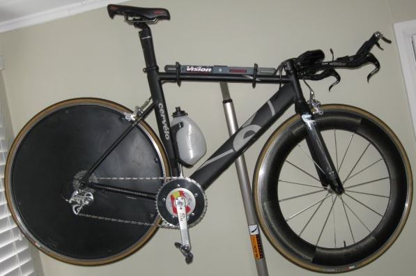

And as far as fast goes - this was my wifes setup for the best time she ever did on our local course (we did 1x before it was cool). Which put her 4th on the all time table - behind a world champs rep, an olympian and an olympic pursuit champion. It is very hard to beat one of those frames for speed/$
Thank you very much. That was extremely helpful. You confirmed what I already knew. Stop thinking about it and just get the cervelo.
Of course, as luck would have it one p1 sold and the other appears to have been taken down unsold. However a p3sl 55cm popped up for $250 less than the p1 I’d been looking at.
I didn’t make the same twice.
Funny enough its the same color scheme as your wifes p1 I. That photo.
