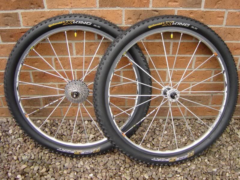

Actually, I often start with the logo’s where God intended (opposite the valve), but relocate them if need be. Thankfully the weight of the logo paint generally balances out the valve, so I’m good to go.
Damn, were polar opposites lol, I have to have mine with the valve !
They have even got to be on the same letter :
http://img.photobucket.com/albums/0903/Peter1/MTB/DSC08315_zpsb2671014.jpg
http://img.photobucket.com/albums/0903/Peter1/MTB/DSC05930.jpg
http://img.photobucket.com/albums/0903/Peter1/MTB/DSC06580.jpg
Although slight compromises have to be made as they are always a little different from one side to the other …
My tri bike is on tubs so I have no choice, at least they agree with me though - logos at the valve … lol
