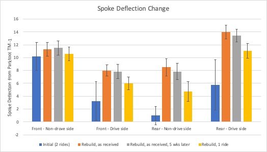

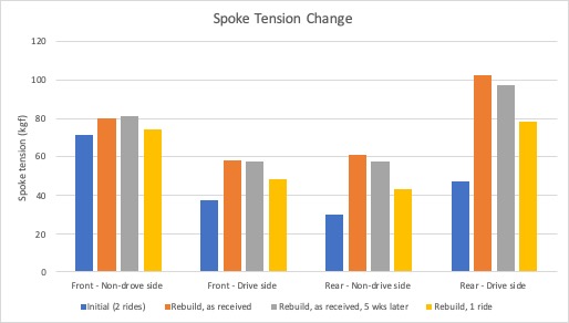

So here is some data and I’m curious as to the technical reasons for what you think is going on so tell me what you think about the reasons for this observation and if there is a way to fix them.
First I received the wheels and I did 2 rides with them - one fast and one easier both adding up to something like 100 miles. When I received them they were straight but after those 2 rides I noticed the tension felt a little low and there was a bit of a wobble in both wheels so I bought a Parktool TM-1 spoke tension meter and started measuring.
  • “Initial (2 rides)” is the spoke tension after these two rides. It was all over the place with many spokes having no tension (max deflection).
  • “Rebuild, as received” is after I sent them back for repair, received them but did not ride them. I only measured the tension without tires/tubes.
  • “Rebuild, as received, 5 weeks later” is the same but I measured them again after sitting in my garage for 5 weeks without tires or any kind of use.
  • “Rebuild, 1 ride” is after setting them up and going on a 30 mile flat recovery ride.
Observations:
  • After receiving them and measuring them the first time (after 2 rides) the spoke tension was all over the place
  • After sending them back the tension was higher but the standard deviation was still high. Supposedly an excellent builder who made them yet I will disagree with that based on my data…
  • A little bit of spoke tension loss in the rear wheel just by sitting in my garage (5-7%, could just be measurement error)
  • Significant spoke tension loss after one ride (8-16% in the front, 20-25% in rear).
Any ideas what could cause such changes? Charts show averages and error bars are standard deviations. Wheels are disc wheels, 24 spokes, bladed steel,1mm x 2.16mm.

I can relate some totally-not-bike-wheels (but on a wheelset with 20+tonnes on it…).
After the initial install / tightening if bolts (spokes in your case) we found that after a week ish, the end load (tension) in bolts actually reduced slightly (5% or so sort of vskue reduction). That’s before a wheel had turned. It was from some localised bedding in / yielding of the material (= your rim material in your case under the spoke nipple). Then after they went into service and moved, they lost a few % more in the 1st few days, but then eventually stabilised. Again more localised yielding of the contact area ie between rim and spike nipple in youe case).
In our case the end load in the bolts was super critical - if a bit of end load was reduced (not totally lost ie not loose) it resulted in more movement and a fatigue failure of the bolts (spokes break in your case)
Why variable across spokes? Id guess there are residual stresses in the rim and they are ‘coming out’ when yoyve ridden.
Yes, I understand that but the level is very different in this wheel set. First time I measured the tension the front wheel had 5 spokes with zero tension while the rear wheel had 8. That’s a clear sign of a serious issue with the build, well beyond just some stress relaxation And to see a reduction in tension of 20-25% after a 1.5h easy ride is also totally unacceptable and would never happen with any other wheel.

Spokes loose tension because something in the system yields (permanently deforms); the spokes themselves, nipples, rims, or hub. Installing a tire and inflating it also compresses the rim and reduces tension if it’s a shallow rim. I built wheels for a living for about 10 years. Once I got wheels up to tension I’d perform at least 3 rounds of stress-relieving (over-stress), and retension, retrue and balancing. On cheap wheels I suspect they just bring them near proper tension and make sure the wheels are true and call it good. These will loose tension and come out of true later.

Over the last few years, I’ve built up a lot of wheels using open mold rims (testing for possible OEM use). I’ve had similar experiences with some of the samples. The last set of rims I tested were the worst I’ve ever seen, and were very similar to what you described. When brought up to tension evenly, the wheels looked like potato chips. The only way it would have been possible to get the wheels true was to have extremely uneven tension. The spoke bed didn’t feel solid (possibly voids, or damaged fibers?) and some spokes would lose tension overnight. The layup appeared to be very inconsistent, the spoke bed depth varied by a couple of mm, which gave the appearance that I had randomly used different length nipples. At the end of testing, we disregarded spoke tension and just got the wheels as true as possible to see what happened, and ended up with spokes that had little or no tension, while others were at the highest recommended tension.
Probably the wheels were built by a robot and had a lot of wind up at the spokes so when you rode it the first time the wheel was stress relieving itself. You can either just re true or loosen up all the spokes and retention and stress relieve the wheel properly. Any competent bike shop should be able to do this. I doubt there’s anything awful about the wheel.
That isn’t stress relieving, that’s just spokes unwinding.
Since the spokes are bladed, I doubt they had any wind up.
The Park TM-1 isn’t exactly the most accurate of measuring devices, even moreso depending on how you use it, so you’re on a loser before you start.
My money is on the no-name semi bladed spokes; from experience they’re normally as stiff as wet spaghetti, or too long.
Better off starting from scratch with a quality round spoke provided there’s no rim damage and rebuilding.
