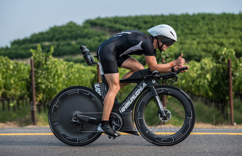

Here is my position at 2018 Ironman 70.3 Santa Rosa:

Thanks guys! I’ve attached a pic - hard to tell cause I’m on a bit of an angle but I also have my stem slightly inclined, I could set that back strait initially (and pull the pads back the get that same reach) and then work my way down.

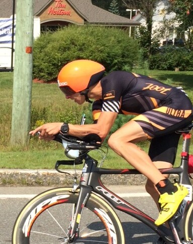

For what it is worth, I don’t do yoga. However, I ride in an extremely aggressive position (not my words). For me it came down to training at home or outside in that position. The thing is if you don’t use a particular muscle group and then heavily use it for a long duration such as for half-ironman you’re bound to have pain. Only by practicing in that position and having those muscles engage over time will the experience become less painful.
your saddle is too high
How can you tell?
with my eyes
i’m being slightly tongue in cheek, but yea, your saddle is on the high side.
with my eyes
He’s probably correct. And when you drop it you will be even more limited by being over-cranked.
What saddle are you on and what crank length are you running?
Just by the crappy photo, your cranks look too long.
And your cranks are too long

175, but it’s got my power meter :frowning: maybe I could switch it over to the road bike and try lower cranks on the tri. Is swapping out lower cranks a game-changer, or it typically helps?
And the saddle is Fizik Tritone.
