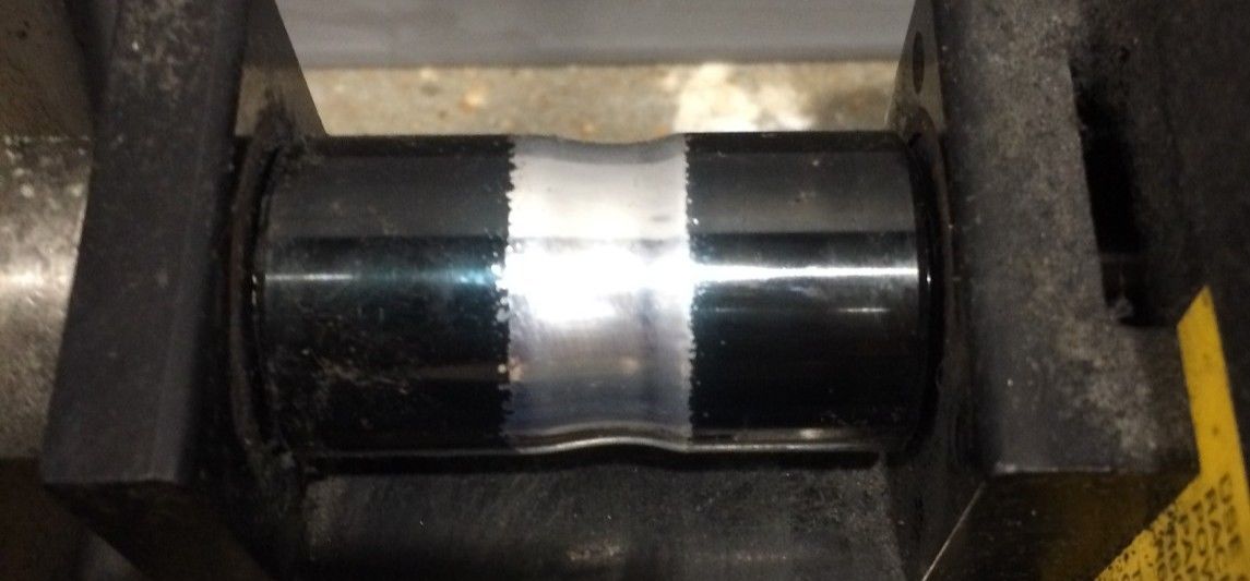

Look at wear on the roller, serious rust on the frame & a warped copper plate inside the LG. If deformed it will often have a ringing noise while spinning.

And here is a roller from a current Ebay listing. I can’t quite figure out how he abraded the thing so much. I’ve never seen one with a visible indentation due to wear.
