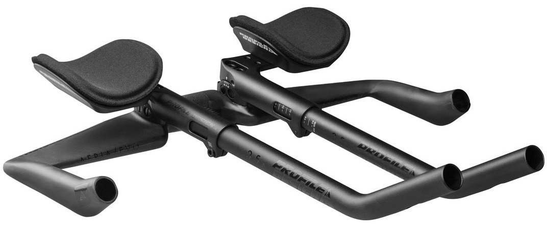

You could get the QR with a PD Aeria Evo bar - that has angled grips
https://www.sefiles.net/images/library/zoom/profile-design-aeria-evo-363742-1.jpg
