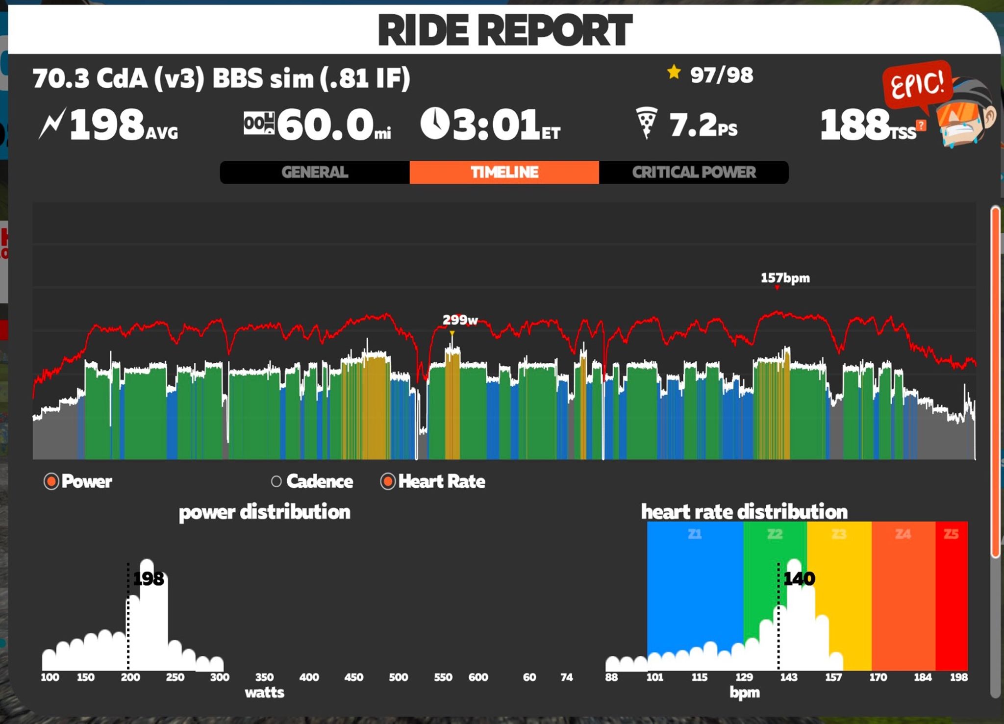

If you want to get a sense for the actual course you’ll be racing on, what I’ve been doing lately is modeling it in BestBikeSplit, and then exporting a file from BBS and riding it in TrainerRoad or Zwift on my Tacx Neo. This way you can ride the exact power profile you’ll be riding on race day.

Did this for a 70.3 I did last year - the exact same power profile as the race, same TSS, same VI - then a little run off the bike to see how you feel. Really helpful to know how that effort feels, IMO

You need to install the Workout Creator app for TR, and then follow the instructions above. Pretty simple to do, and as sch340 said, it’s invaluable to be able to ride the exact power profile, TSS and VI, and then run afterwards to gauge how it feels. for 70.3 CdA I ended up going through three or four iterations of the BBS plan, each time tweaking target VI and max power, until I had a plan I felt comfortable that I could run well afterwards.

I’ve done it several times, and it works flawlessly for me in both TrainerRoad and Zwift. The problem you’re describing is a function of your trainer, not BBS, Zwift or TR. One thing I discovered a while back is that my trainer (Tacx Neo) is FAR better at evening out spikes and holding a target power in erg mode if I’m in a “small” gear (i.e., 34/25 rather than, say, 50/11). Here’s what one of my BBS rides in Zwift looked like.

I’m not familiar with your setup specifically, but if you’re already using TR with that setup, then riding a BBS course in TR wouldn’t be any different. It would essentally just be another ‘custom workout.’
I went back and re-read your post, and I think I understand the problem. What you’re describing is that you’re trying to ride the actual .GPX profile of a course. I’m guessing that the trainer is going to try to simulate every single change in grade. I can imagine that, with any sort of lag, that would get really annoying.
That’s not what BBS does. BBS already applies some ‘smoothing’ to the elevation profile. For example the 70.3 CdA profile I showed above had 98 ‘segments’ or individual blocks where the power profile changed. These were each typically 1-2 minutes long. If BBS got any more granular than that, your power target would be changing every few seconds and it would be nearly impossible to follow. So, when you’re riding a BBS simulation, the power target isn’t changing continuously, it’s changing every minute or two, which makes it both easier to ride in TR or Zwift, and easier to follow on race day.
That sounds a lot better. The last time I did this was 2+ years ago, so my memory of what I did is spotty, but I did try and run it through BBS to get a trace, but I’ll bet I didn’t use BBS and that would give me the jumpiness I got.
1-2 minutes per segment would work great - I’ll def give it a try in the future. Thanks for the heads up!
