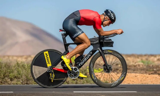

After a very positive change to my aero-position on my tri/TT bike, I am now finding myself limited in terms of “line-of-sight” when (in training) riding with my Oakley ARO 5 and Oakley Jawbreaker. There is no gap between glasses and the helmet (good integration done by Oakley, but not good for this position)
Below photo (not me) illustrates the issue, with obviously other helmet/glasses.
With my aero helmet (Met Drone) I do not have this problem at all, vertical area of vision is much bigger here.
Can anybody recommend a good combo that clears better the line-of-sight? TIA

I race in a Met Drone as well using the visor and train in a Giro Vanquish with the magnetic visor it comes with. I prefer a visor on my tri bike over glasses in training and racing for the reason you are trying to fix.

Scott Cadence Plus and Oakley Jawbreakers. I don’t have a big problem with the frame blocking my vision. I find that Oakley helmets are just awkwardly big.
I have been using Rudy Project Cutline glasses and taking off the bumpers so there is no frame across the top. I was sort of amazed how much more vision it gives me.

Tifosi makes a frameless sunglass that I found works great in aero no matter how aggressive or non aggressive i ride.
For training i use glasses from Smith Optics, they are border-less and work great.

I use the Tifosi Podium for that issue
Oakley EV Zero sunglasses. Got these because my jawbone’’s frame caused too much obstruction.

If it isn’t stinking hot, I train in a TT helmet with visor. No visibility issues. If it’s a bother, try to find a used or more affordable less aero TT helmet that has a visor but is more ventilated.
With a lot of the modern positions anyway I feel you have to teach yourself a “nervous tick” of timing out your pedal stroke count and a “peek” up road. Ain’t no way folks are able to crane their neck a meaningful distance up road in a lot of these positions for hours on end. If a dog/deer sprints out, you’re not going to react in time anyway if it happens between your “peeks” versus always looking up. But you can look up during driveway crossings or anywhere something would enter your path.

I CAN see fine ahead if no helmet / glasses frame obstruction. Will look into suggestions.

I will second that the ARO5 is awkwardly big and heavy for that matter compared to other helmets. I’ve had one for several years for training and use the ARO7 with visor for racing. I would look at some of the Rudy helmets, Nytron or Strym, MET Rival or Manta, or Kask Protone. Roka SL 1x glasses or the Oakleys mentioned without the bar across the top of the glasses provide the greatest amount of visibility.

I just stopped using the road helmet on tri rides. I use my giro arrowhead now and just don’t worry about it anymore.
I love my Roka GP-1X for this purpose. I usually shift my helmet slightly further towards the back of my head and tighten, very similar to what I do with my aero helmet. This gives me full visibility. I would not ride in aero position with my normal Oakley Radars, I have nearly 0 visibility.

Oakley frameless or top-frameless are my go to for glasses. Currently using Fight Jackets (cold temps) or EVZeros (warm temps and current favorite).
Helmet of choice for training is my aero road helmet, a Lazer Vento. It’s nice and high above the brow for a clear line of sight. My Giro Aether is cooler but too low on the brow and blocks my vision.
