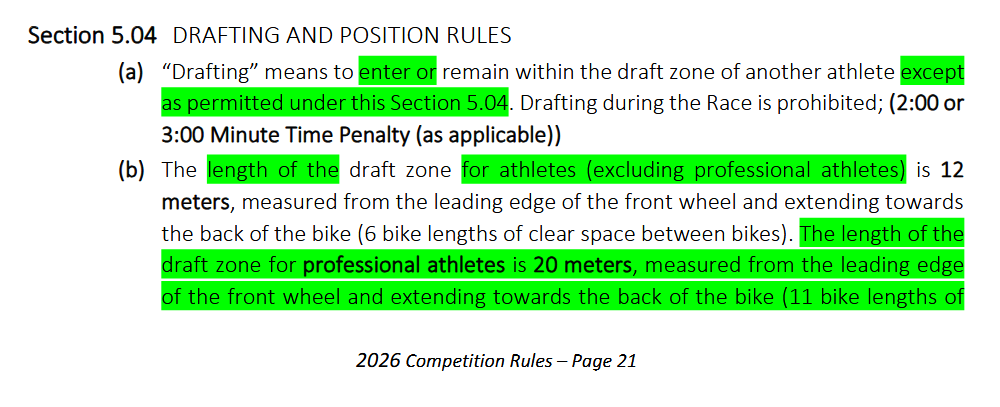

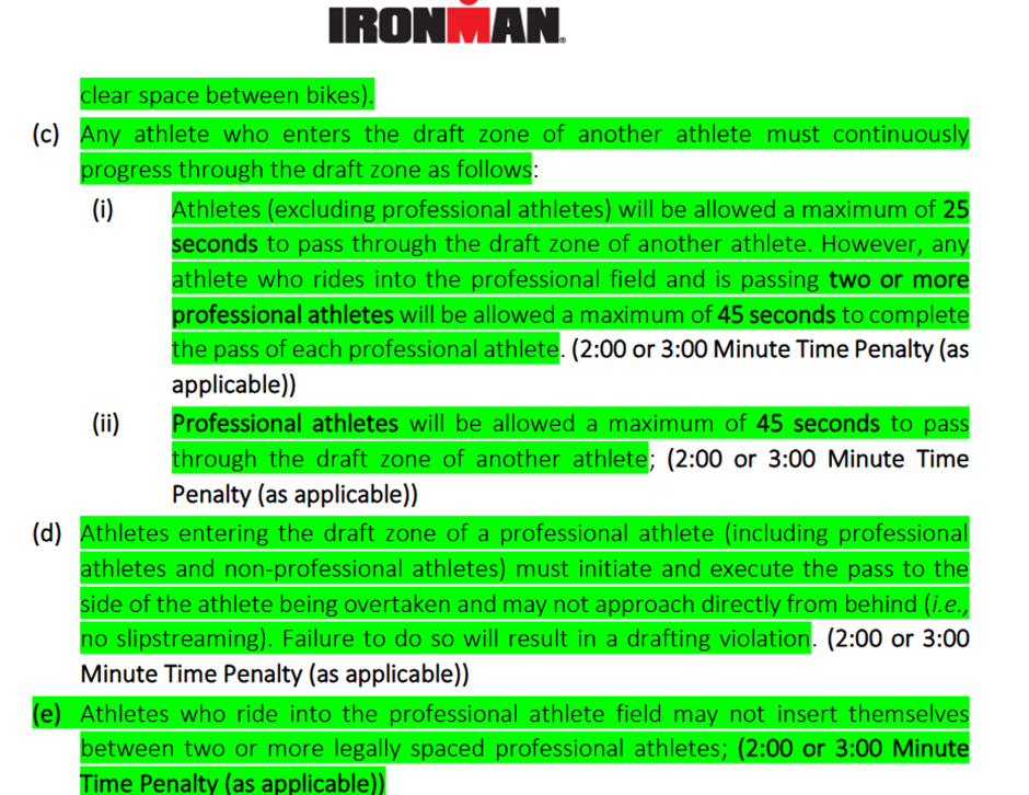

Here are the relevant passages amended in the 2026 Ironman Competition Rules, published today (23rd February) to effect the 20m draft for Pros and deal with the complication of amateurs “riding [up to]” one or more pro athletes.
