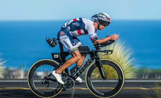

I mounted my elite bottle to my top tube cervelo p2 only will go in reverse. I think TO had his setup on his trek at Kona. bottle drips especially if filled all the way up because mount faces down and top tube is perfectly horizontal.

Ha! I almost did that to my old p3 but chickened out due to the curve of the top tube. But you slightly misunderstood, the Omni actually has bosses there by default! Which is super convenient. If the aero bottle is really that leaky maybe modified flat kit could go there.
You are right. I looked it up.
That particular water bottle location on that frame was damn-near aero neutral in my testing.
