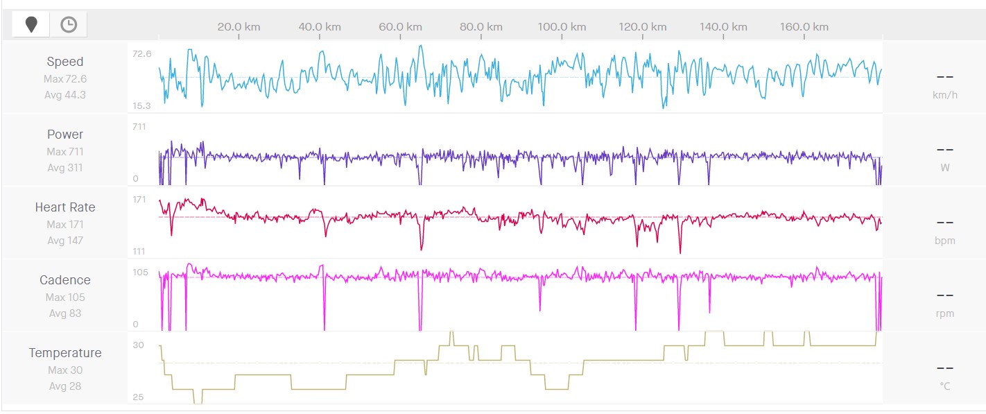

His Strava graph doesn’t show much of a change from what I can see, but likely given the speed increase and tailwind. He showed only 147HR on the bike and 150 on the run, even at that level it’s mind boggling to see numbers like that.

Did he just put the hammer down?…
no
Power was consistent.
Would need power data from the others to work out whether they backed off.
