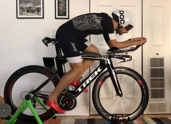

You don’t look super aggresive but it’s not an overly upright position either. Position critique aside, looks like your saddle height is 84 so you must be pretty tall. Most likely you would need to be on a size XL but since Canyon doesn’t make anything larger than L you’re out of luck I guess.
For comparison, I’m 6ft and ride a Trek Speed Concept size L with Pad Stack 620 and Pad Reach (mid pad) of about 515 and my seat height is about 75cm. I would fit just fine on a Canyon M or L.
Here’s what I look like:

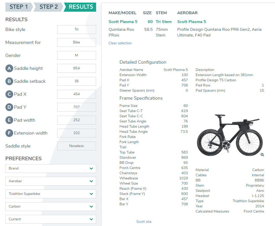

The plasma fits easily
Hey,
Thanks so much for your response and great to know the Scott would fit my geometry. I’m a bit confused though… When I went on their website to check the geometry of the bike, I found that the max stack height was 600mm. Are you saying that can increase?
On another note, what program do you use to compare bikes according to a rider’s geometry? It looks like brilliant.

The “stack” is the distance from the center of the BB to the top of the top tube. This measurement doesn’t include the stem height or the spacer height to the pads. The stack cannot change but the height of the pads can be much higher than that.

As Conky mentioned - the stack listed on the Scott site is the Frame Y, what you need is Pad Y
The tool I’m using is the velogicfit Advanced bike finder which is brilliant*
There is a pdf for the Plasma 5, as described here http://www.slowtwitch.com/Bike_Fit/General_Fit_Articles/The_Plasma_Gets_a_Prescriber_6269.html
*note that I am the founder of velogicfit…
